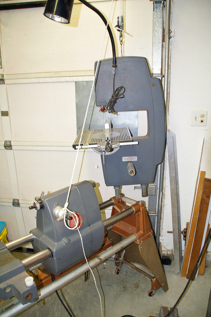

Take a look at my post a few days ago in the Maintenance section. "Awkward Band saw". when you look at the pictures, I have since replaced the hinge with a much heavier hinge with bearings.

That is exactly what I wanted to see! I can't mount fully to the wall, though I can anchor it to a stud so it won't tip. Best I can tell you don't have it travel across the arm, just pivot at the hinge, and that will make it easier.

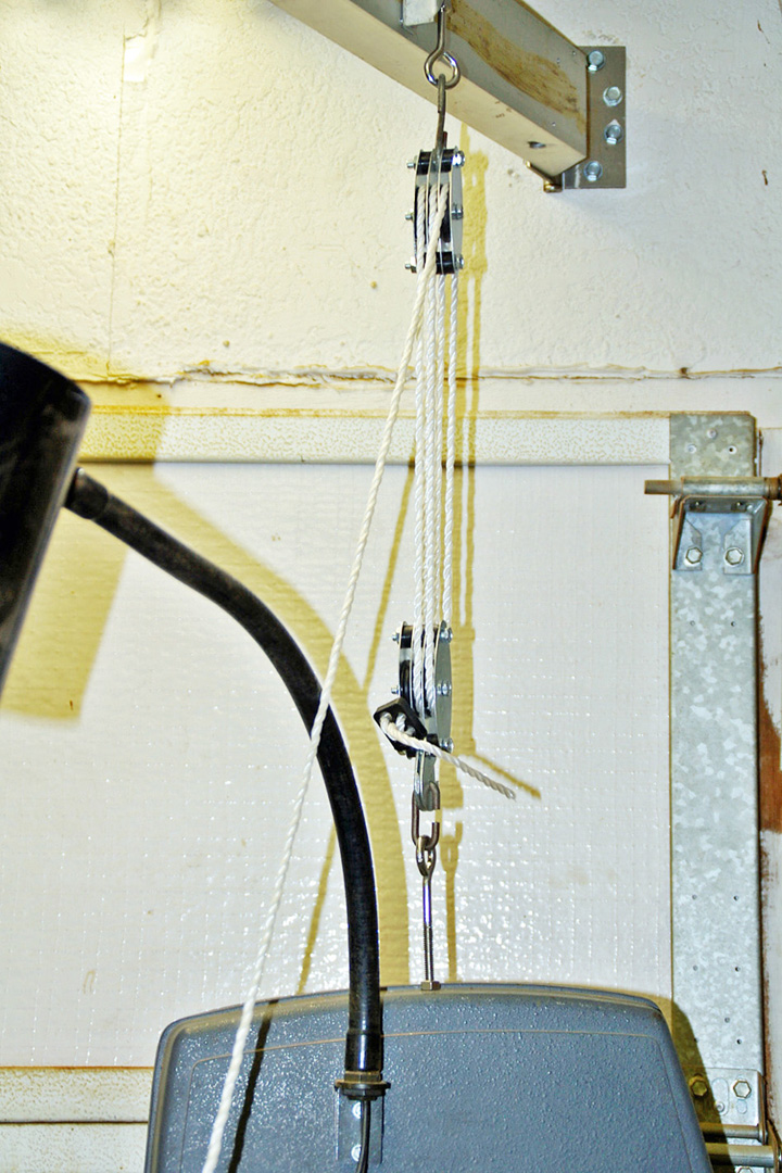

I am not sure you are seeing this rig right. The eye on the swinging beam doesn't move. It just swings away from the wall and I position the SS under it. See the attached pictures.
Further, you mention not using a header but instead using a stud. If it were me I would think about using a short piece of a 2x6 or something similar and spanning two studs and trying to get good contact with the lag bolts from the front or carriage bolts from the rear. Just a thought!

Don, Yeah, I did see it correctly, I just didn't write coherently. I meant I liked that you accomplished the function without needing a slide.

For everyone's information the Block and Tackle you see in the pictures is the "El Cheapo" I picked up at HF to see if the idea was plausible and because it was Sunday. My intent is to upgrade if necessary in the future, However for now it does the job it is intended for. I don't believe it will be used that often anyway.
