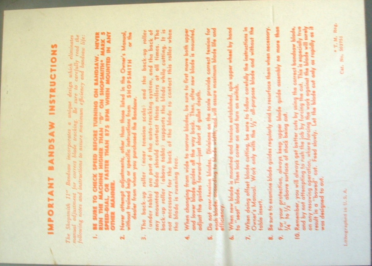

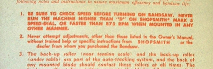

I was thinking of re-making the label that is affixed to the inside of the cover, but some of the words are long since gone. Can anyone provide the missing words:
IMPORTANT BANDSAW INSTUCTIONS
The Shopsmith 11” Bandsaw incorporates a unique design which eliminates manual adjustment for correct blade tracking. Be sure to c...???... the following notes and instructions to insure maximum efficiency and ...???...
1. BE SURE TO CHECK SPEED BEFORE TURNING ON BANDSAW ...???... RUN THE MACHINE HIGHER THAN “D” ON SHOPSMITH ...???... SPEED-DIAL, OR FASTER than 875 RPM WHEN ...???... OTHER MANNER.
2.Never attempt adjustments, other than those listed in the owner’s manual without trained help or specific instructions from SHOPSMITH or the dealer from whom you purchased the Bandsaw.
(The rest I can make out)

This is the label in my bandsaw, mid 80's, cast iron table.
Sorry it is displaying sideways, it is right side up before I download it.

Other missing 'words' are carefully read :)
