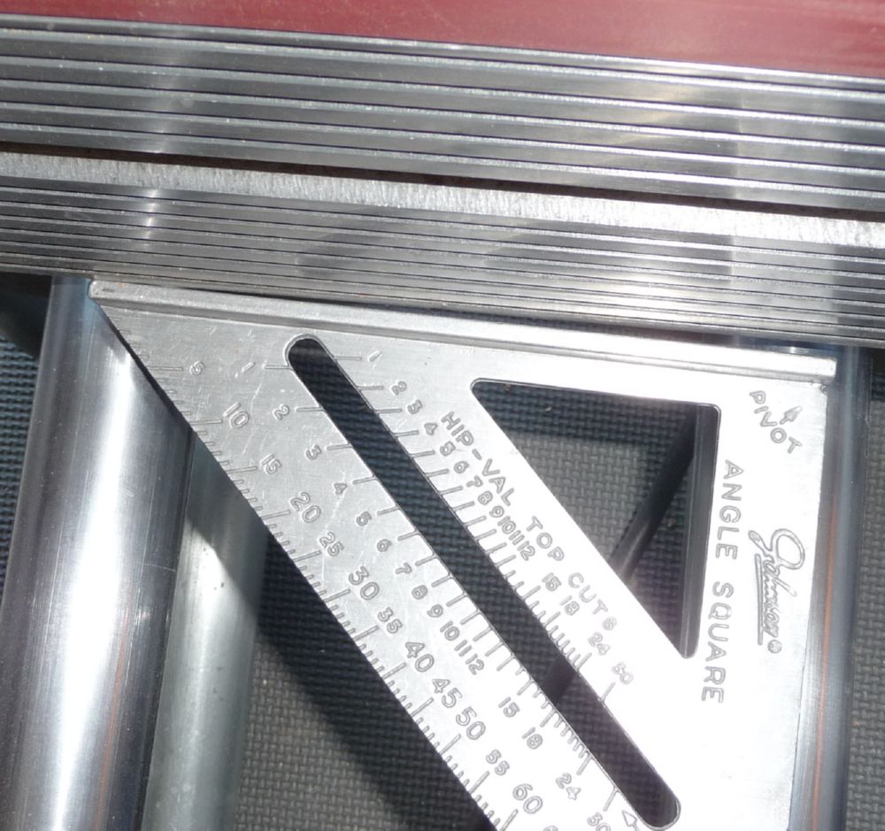

I looked through the '84 Mk. V manual and have nothing that helps. This is a 510. The table is not square with the tubes. What is the fix?

BTW: In the photo you posted, the square does not appear to me to be positioned properly with the tubes. Snug it to the table and then eye ball the square in reference to the tubes for a different view.

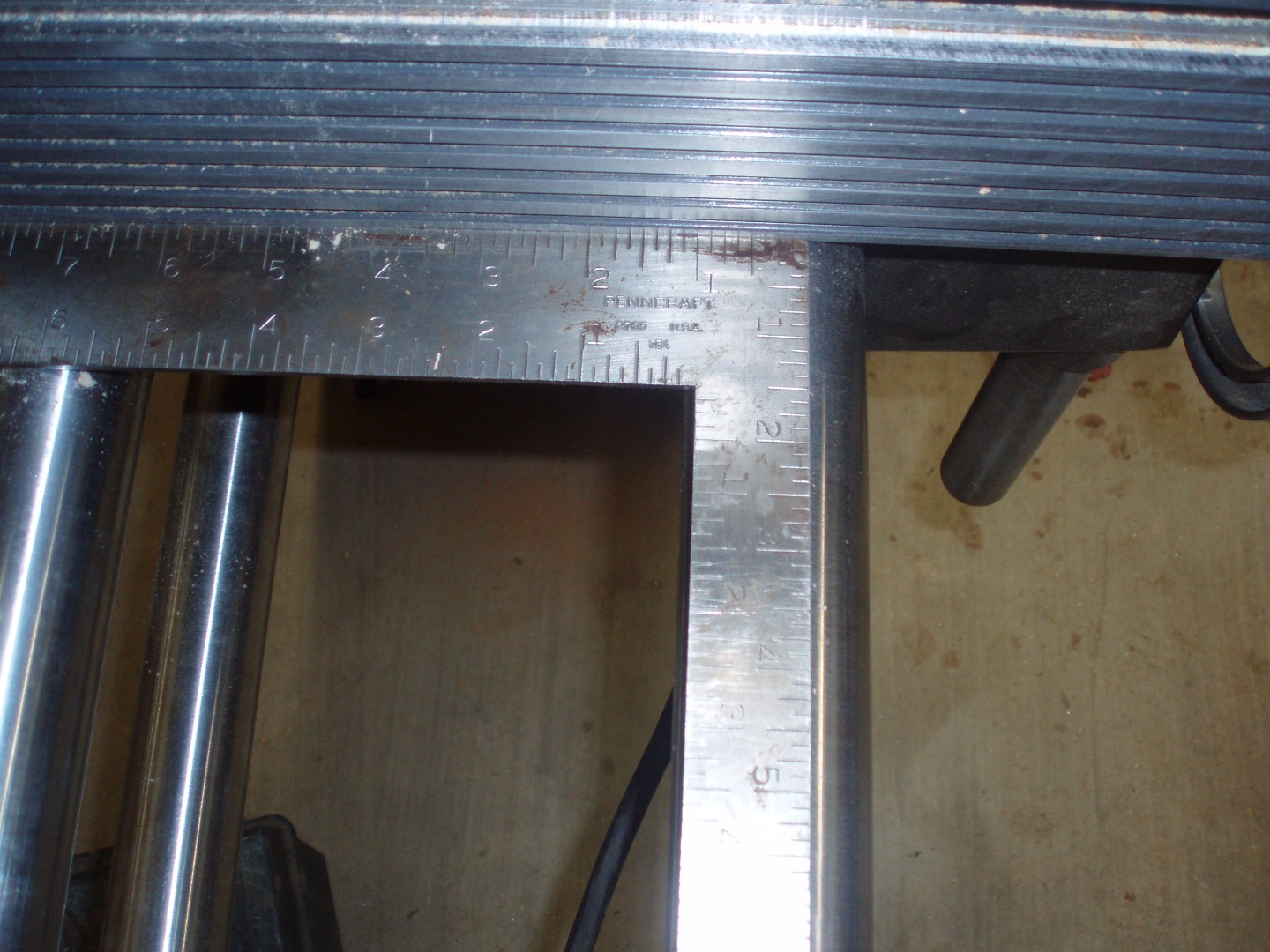

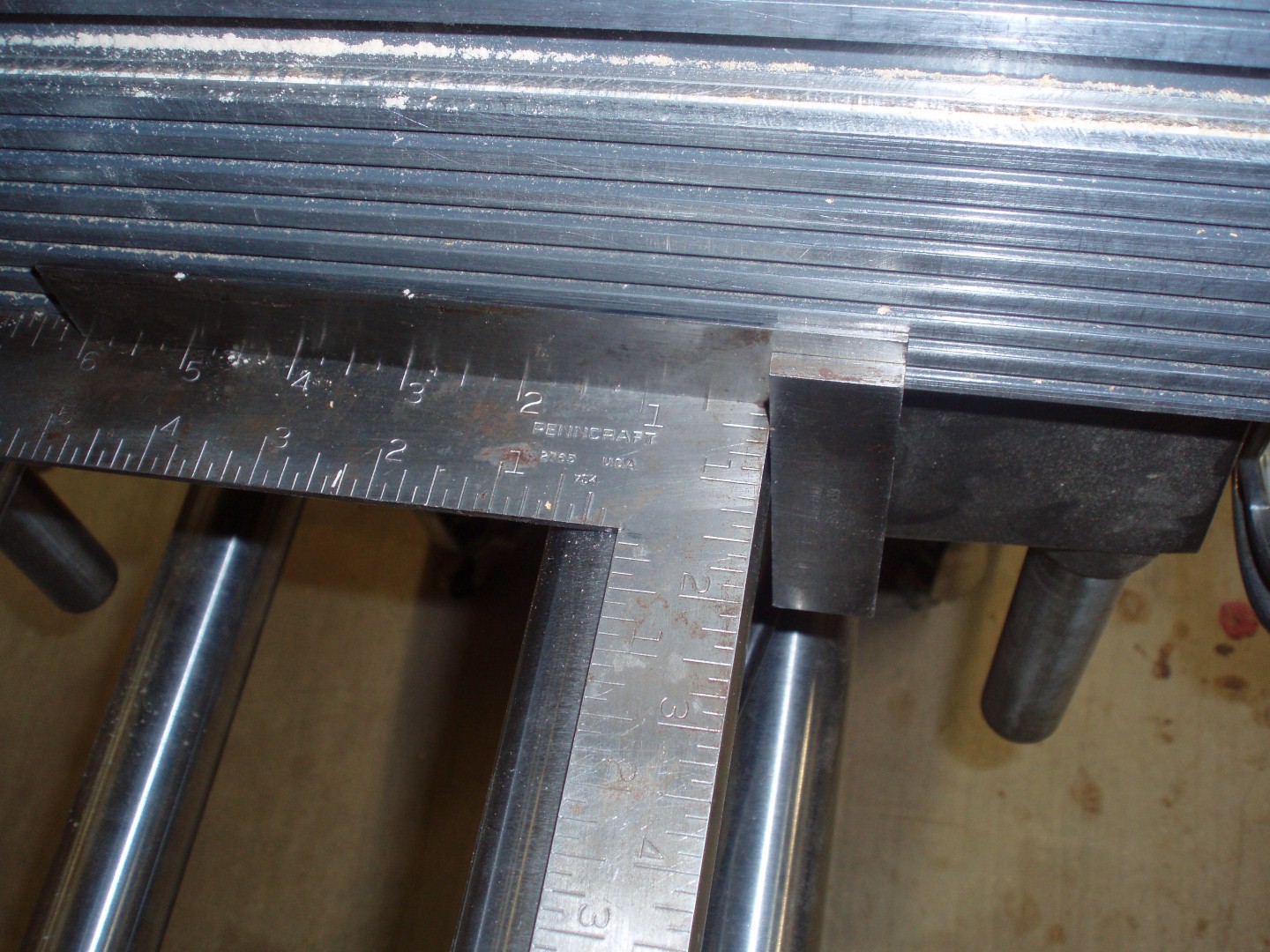

These images show the angular relationship between the Shorty's Main Table and the Way Tubes.
Furthermore, I have no response EXCEPT to ask this question. Are there any shims on the four trunnion bolts (between the tables under surface and the trunnions)?
- Squared to the Main Table
- Main Table Square to the Tubes 001 (Custom).jpg (313.61 KiB) Viewed 1161 times
- Aligned at one end of square with Way Tube
- Main Table Square to the Tubes 002 (Custom).jpg (393.6 KiB) Viewed 1161 times
- Aligned at other end of square with Way Tube
- Main Table Square to the Tubes 003 (Custom).jpg (339.57 KiB) Viewed 1161 times

I agree with Dusty the square does not appear to be aligned to the way tubes making 'the problem' appear worse.

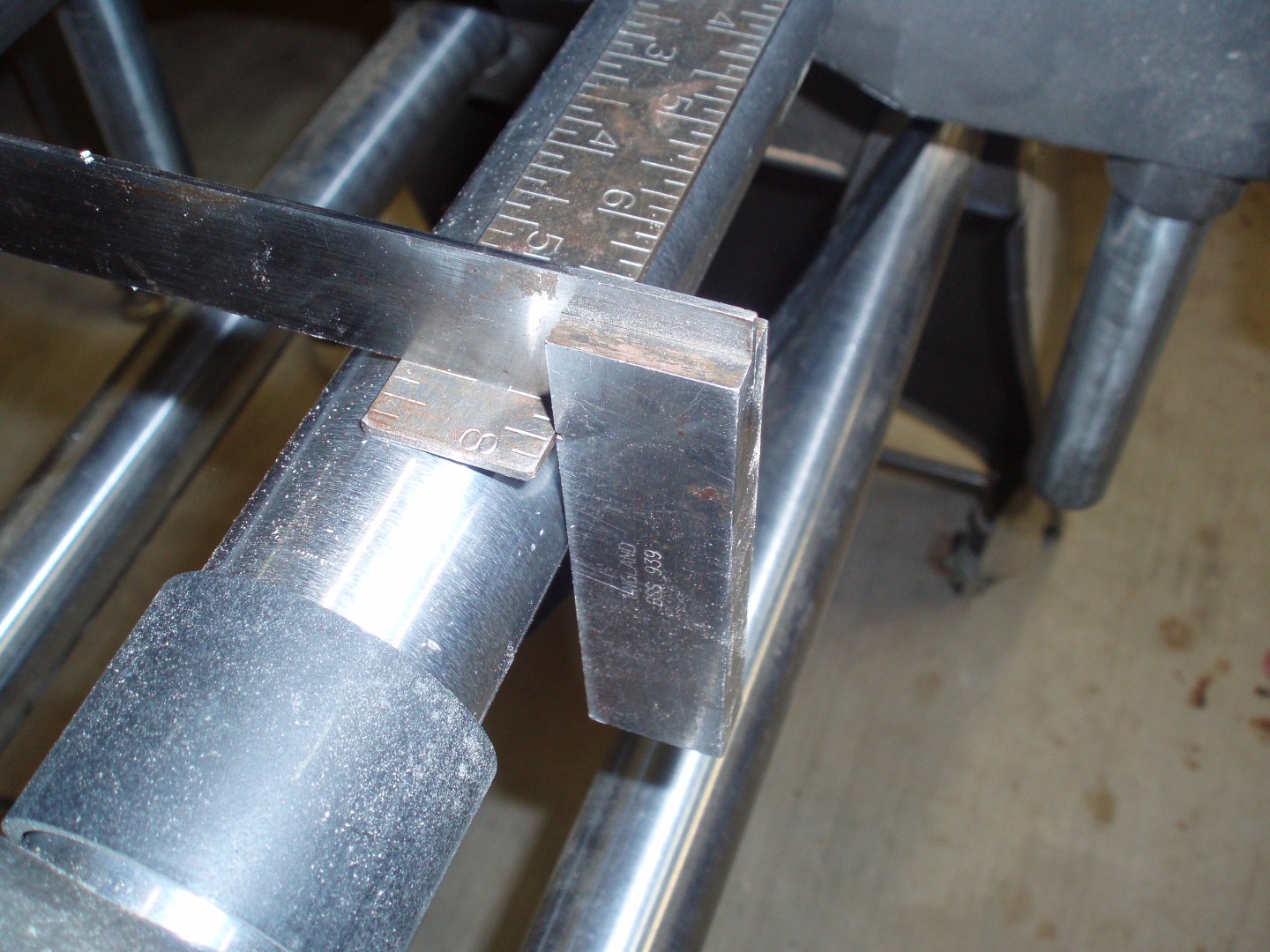

Note how Dusty checks square to way tubes alignment with an additional square. Getting a reference to the waytubes is difficult otherwise.
