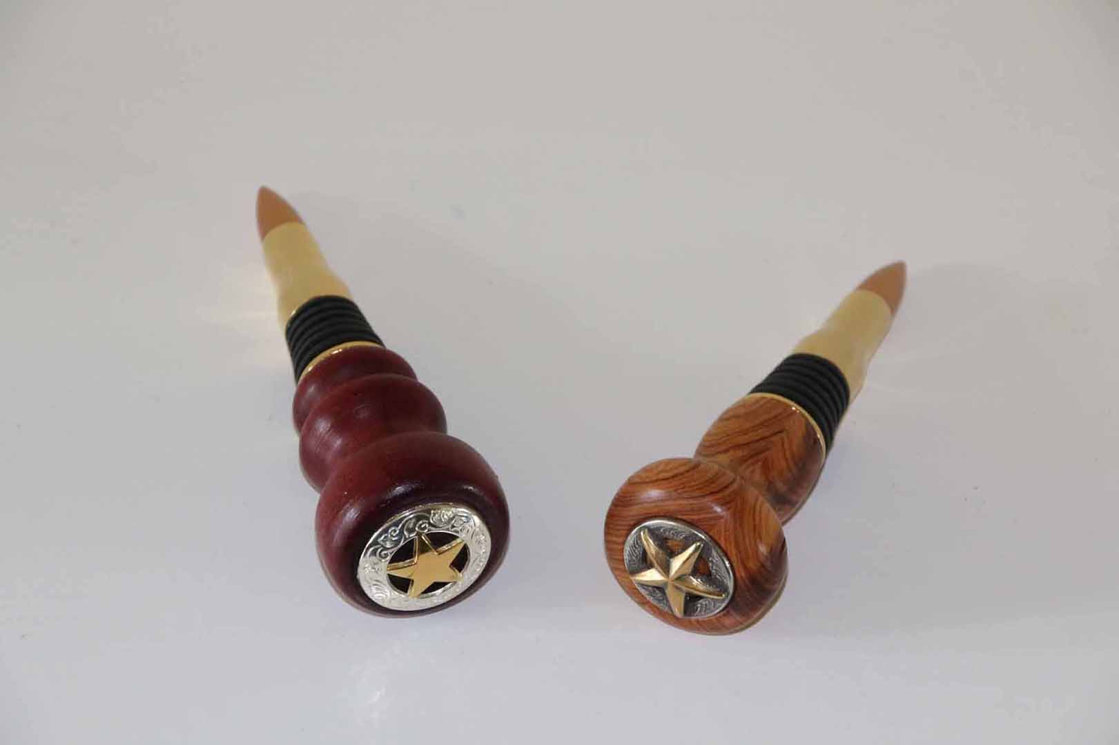

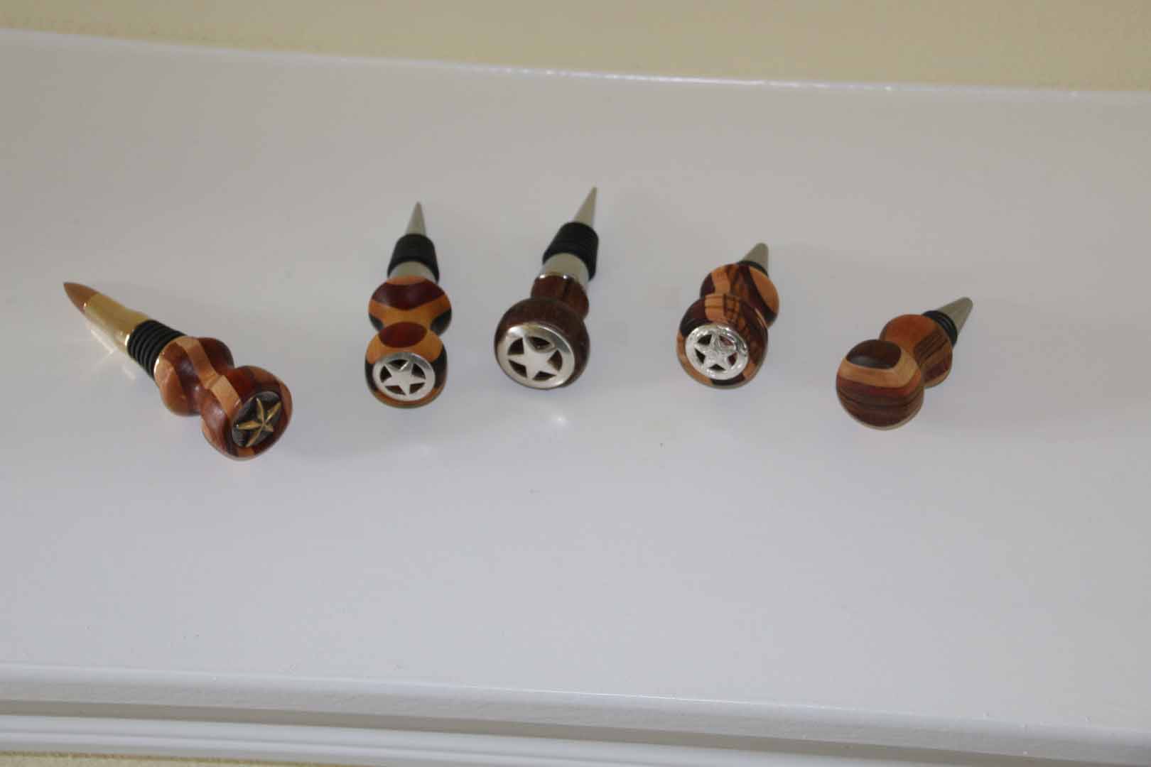

I have been using the wine stopper screw chuck from Niles or about a month now. As reported by others really a very good option for wine stoppers. Attached are a few of the stoppers I have been making. Thanks for the suggestions.

Post by wa2crk »
c2h6o
The pix you tried to upload did not come through nor does a link appear. Can you try to repost?

I hope these come thru--the file size was too big for the site.....
