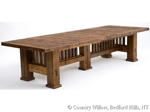

thanks guys.A lot of good points here.The only way try to mimic the dry climate ,in my opinion woul dbe to kiln dry the materials and get right to building as they come out of the kiln ,keep parts in the kiln as i go.i have a smaller home made kiln that I can use.My plan is to make the top in two pieces and the base structure in two or three pieces also.finish and assemble on site. I've never seen kiln dried heart pine though.Not sure what it will do when kiln dried.It's surprisingly dense and seems wet after hundred+ years in most cases. i'm hoping they go with the Douglas Fir myself even though I prefer the Oak for overal looks .Here's a picture of the style they think they are after.We'll customize the final destails to their taste.This will be a great project once we get the details figured out. i'm having a hard grasping why they want it 7ft. deep but that's their call. I believe if the top is any less than 3" it will look too thin.

Re: Opinions wanted on wood choice.
Well that pix sure flipped some things in my mind.
I noticed two major things different from my initial perception.
First, the top planks run 'across' the 7' width.
Second, the length is truncated to two 7+' sections.
Good reason for both.
By reversing the plank direction and splitting it up minimizes the 'climate change' effect. The major expansion will occur end to end(assuming my initial grain oeientation) rather than across the width. Splitting it into two 'ends' halves that effect on each 'end'. By making it 'sectional', the weight to move each section is halved.
Also the max length needed it reduced to below 8'.
An interesting endeavor fer sure.
I'm not too worried about the top shrinkage whether the boards go lengthwise or crossways.The Grain orientation should minimize this.I the top is installed to mor eor less float atop the base I think it will be good to go.
