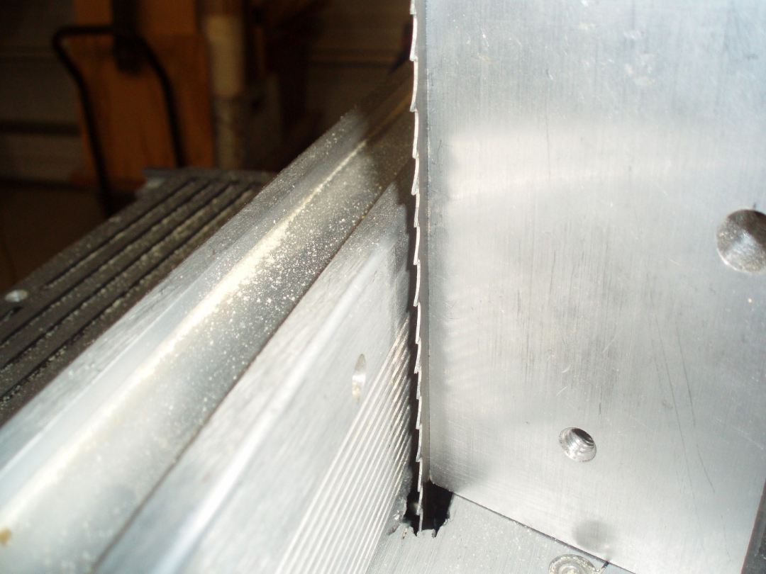

I didn't do that. I checked the blade for perpendicular to the table, mounted a feather board and started cutting. I got some good clean cuts but of inconsistent thickness.
These images tell it all. A stock fence, at least this one, is not precisely square to the table and would not give good results when resawing thin stock.
This "attitude" caused me to have more faith in my band saw than maybe is warranted.
I took to the shop to demonstrate to myself than I could resaw 1/16" pieces with no problem at all. Those of you who use the band saw this way already know what the results are. Defineately not as good as I would have thought.
However, it is not because the Shopsmith Band Saw is incapable. It is because this task is going to require some meticulous set up.

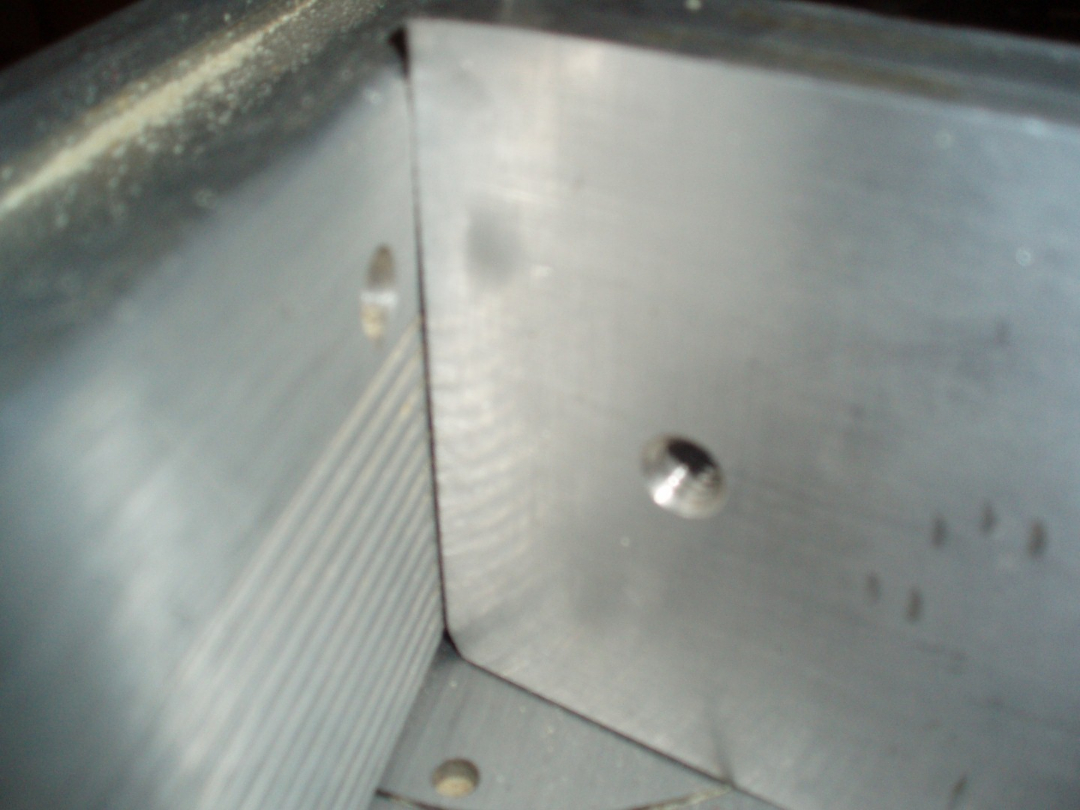

- Blade is square to the table top.
- Shopsmith Adjustable Bandsaw 002 (Large).jpg (670.06 KiB) Viewed 9675 times
- Fence is close to square but in adequate for close tolerance work.
- Shopsmith Adjustable Bandsaw 008 (Large).jpg (617.76 KiB) Viewed 9674 times

It became obvious to me that an adjustable fence is required if I am going to do any critical resawing. I do now understand what others have said about their disappointments with resaw results. I did not before this and I more often than not disregarded their criticisms of the Shopsmith Band Saw.
In my specific case, the stock band saw fence is the issue. Once resolved, I will revisit this thread.

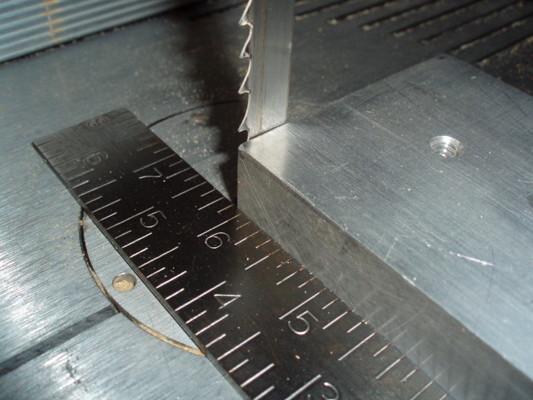

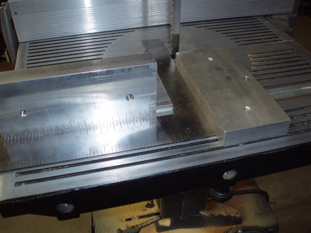

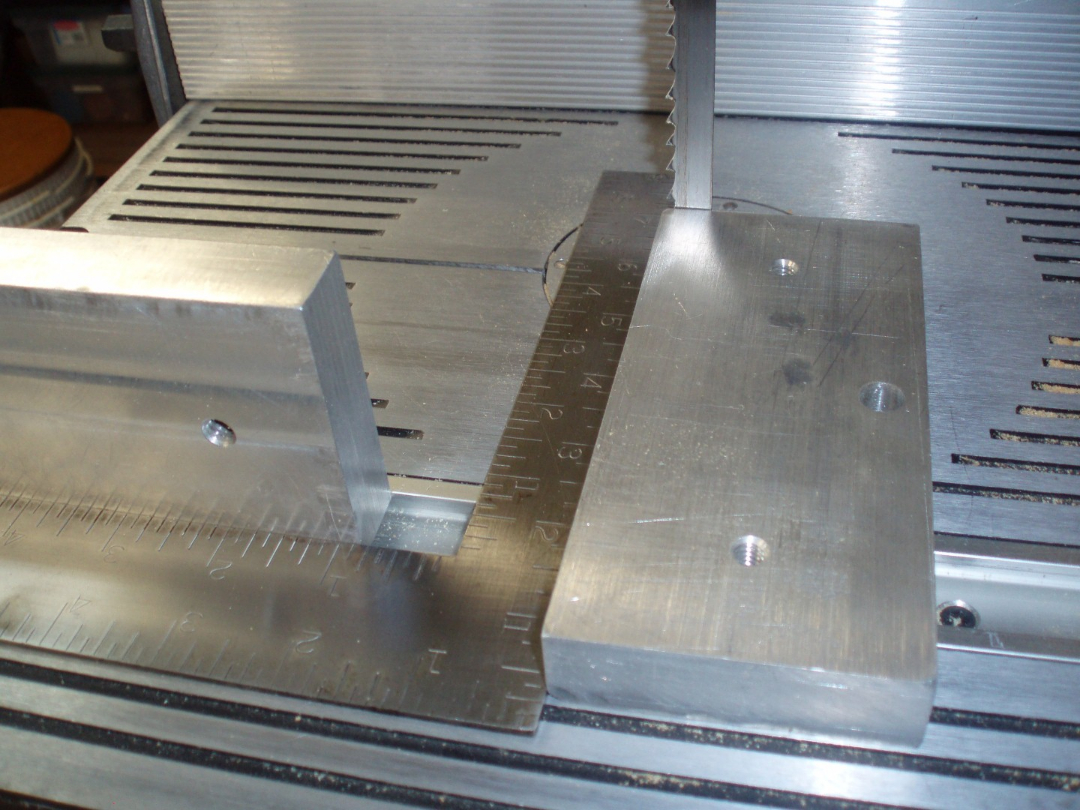

It is my opinion that installing Carter guides will improve nothing when resawing on the Shopsmith band saw. Why? Because the bearings and cool blocks already do what is necessary.
When using a wide blade (resaw blade), I squeeze the cool blocks down so that they touch the face of the band saw blade.
Alignment, in preparation for resawing, is done essentially the same way as for the table saw with the major difference being the narrow width of the blade. Basically, I align to the miter track and check those results against the blade.
- Shopsmith Adjustable Bandsaw 015 (Large).jpg (813.19 KiB) Viewed 9594 times
- Shopsmith Adjustable Bandsaw 017 (Large).jpg (813.97 KiB) Viewed 9594 times
- Shopsmith Adjustable Bandsaw 019 (Large).jpg (880.59 KiB) Viewed 9594 times
