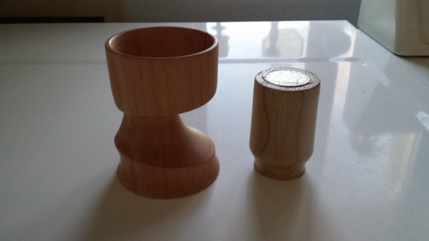

OK
Here is what I did with the paperweight
Instead of dealing with a cap and all, I just turned a recess to accept a glued in Turkish coin that was laying around.
I got the smallest lead sinkers, 120 total, as I put them in I added some inlace that I had that I didn't like the color. It was thinner than resin so I thought it would seep better. worked out well. thanks for the comments.
The little "ring" cup on the left is something I was playing with when I wanted to do an offset item using 2 of the 4 jaws of a chuck.

Glad you got it done safely.
And, I love that offset turning.
