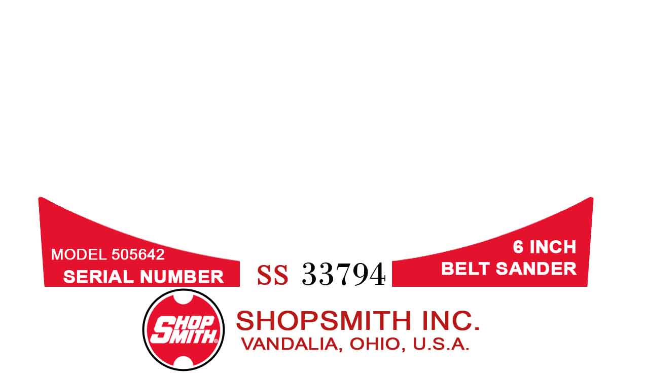

Thanks again to all who have gone before me -- especially Bill (above) and JPG who has done a similar refurb (sans Bondo). While the paint dries I'm busy in Photoshop working on replacement labels. Unlike JPG, I can't seem to get them off without damage.

Work in progress:
- Belt Sander Serial Number Repro
- BeltSanderSerial_Repro.jpg (55.94 KiB) Viewed 5807 times
