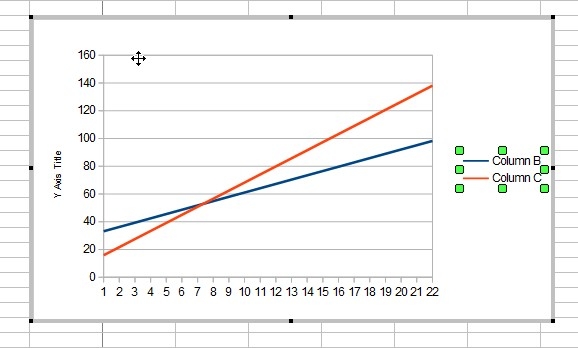

To get more into the process I said well if I use 50,000 hours as a starting point then I would need to buy 3 of the 18,000 bulbs to get at least to that point. The 3rd bulb would still have time on it when we get to the 50,000 hours but I didn't want to deal with that. Simple math says the bulbs (3 at $3.33) = about $10.
For things to be even, if I'm thinking about this right is the difference in costs of the bulbs has to be made up for in electrical costs. So if the bulb lasts for the 50,000 hours and I multiply the 17(watts) * 50000(hours) then divide by 1000(kwatt) this would leave me with the kilowatts used, about 850. Our current rate is $.08 so a cost of $68.
Using the same thinking (32 * 50000)/1000 = 1600 or about $128.
If we add the total cost of the LED bulb at $30 and usage $68 or a total of $98. The existing bulbs would be $10 and usage of $128 or a total of $138. The LED bulb would save $40 over its life.
The savings would start after about 7 years, so if things don't go that far it would not be much of deal.
