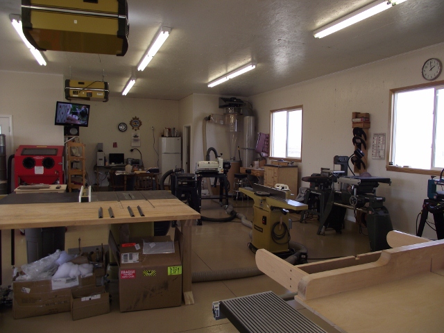

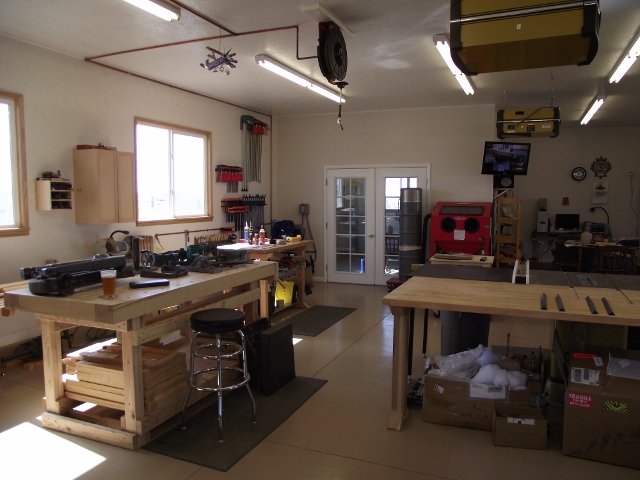

Posts: 6584
Re: Personal air filtration
robinson46176 wrote:A lot of the molded mask don't fit well over my beard so I have just been using disposable surgical mask. They have been fine for me.
http://www.amazon.com/Famixyal-Disposab ... B00MLPTDG4
I have a 1.5 HP Penn State dust collector and a 2 HP HF dust collector. I need to get busy on an over-head air scrubber...
In my opinion they are worth every bit of what you pay for them. I have two Powermatic filters in the main shop and a JDS in the clean/finishing room that I had in the garage shop before I built the dedicated shop. The clean room is 10' X 12' and is at he back of the shop to the left of the blast cabinet in the picture.
They are mounted in opposite directions so it creates a circular air flow to hopefully create more efficiency.
