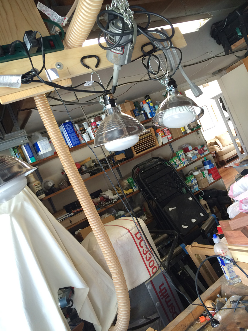

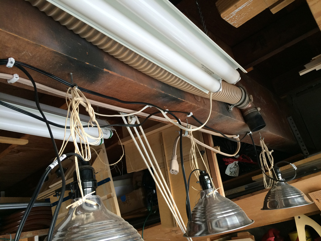

I don't use anything that complicated - I don't have room. Since I only use one machine at a time I plug a hose into the DC outlet on my ceiling and hook it up to whatever.
DC 02.jpg (333.15 KiB) Viewed 7174 times
I have the 16 feet hose running from the DC over to the hose outlet.
DC 01.jpg (374.45 KiB) Viewed 7174 times

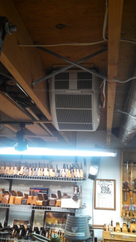

Couple of suggestions. [I would have posted a picture, but I am having trouble getting it uploaded]. I purchased from one of the big box outlets a HEPA filter unit that I mounted in the rafters of my shop. When I am doing really dust making stuff, like running a router, I will turn it on one of it's three speeds and leave it on for awhile. When I am doing really dusty stuff I also wear my chemical warfare mask that I kept when I retired from the military. :D

I got the pics uploaded. Below is the HEPA machine in the rafters.

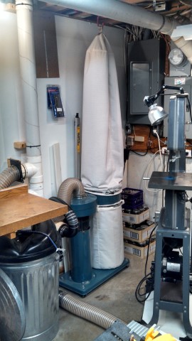

Here is my 4" system with the 10 micron bag above. Note the additional trash can to drop catch any metal or other particles the could damage the impellers. I use a remote control 110V plug-in with the button on my apron. Then all you have to throw are the gates.
