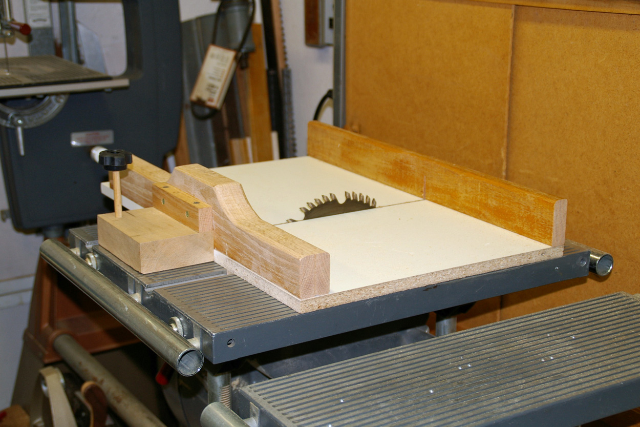

While watching it snow yesterday, I coincidentally decided to use a piece of Melamine to make a sled. I really don't know why I have a perfectly good Dewalt radial arm saw. In any case it was really just something to do. I don't recommend using Melamine because it is so prone to chip while trying to re-center the blade to the sled slot after removal and re-install.
It won't be used for anything but horizontal cross cutting, no intent to use with the table tilted. The dowel drops into the existing hole in the SS table to keep from cutting too far into the sled as a safety more or less.
Don G
