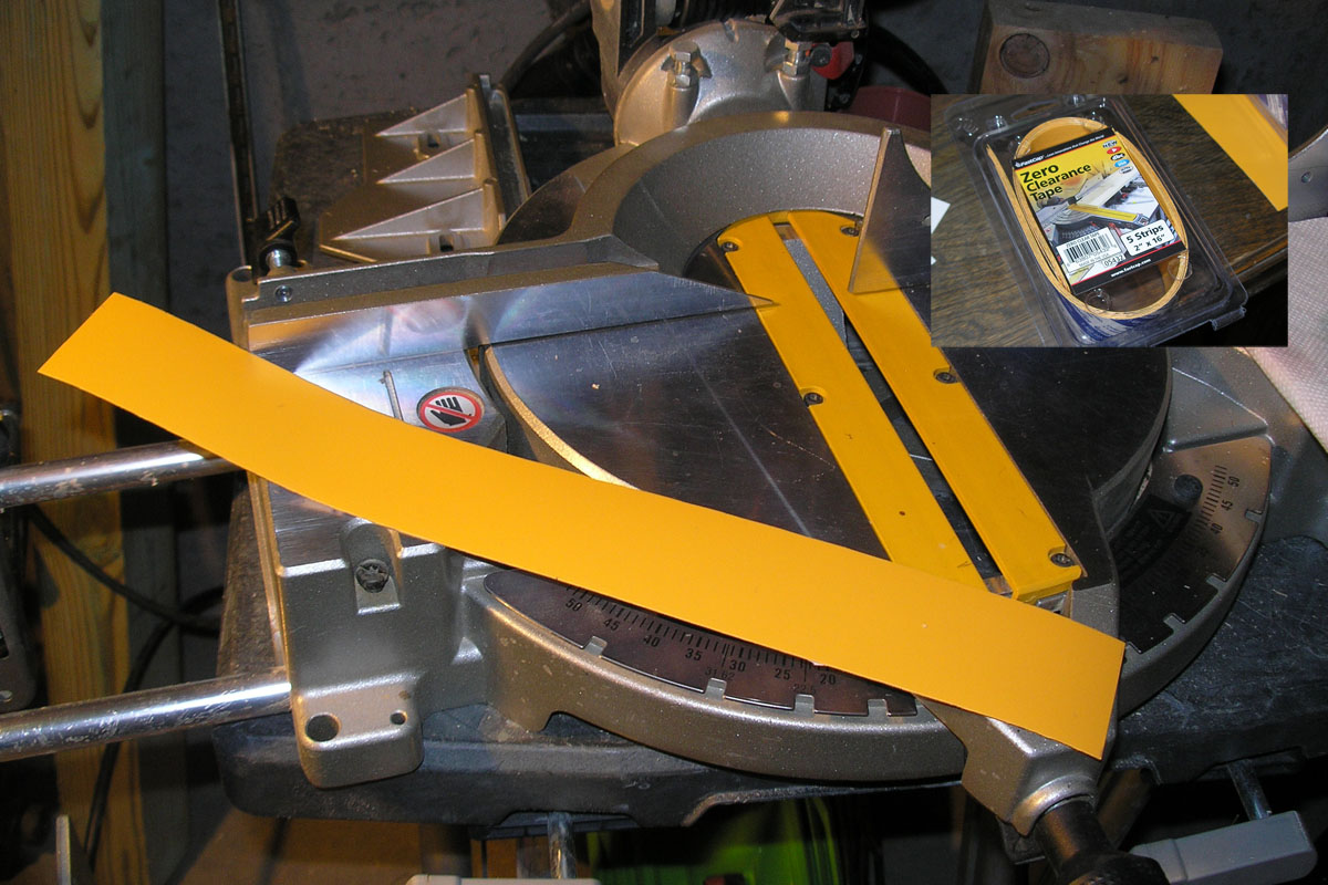

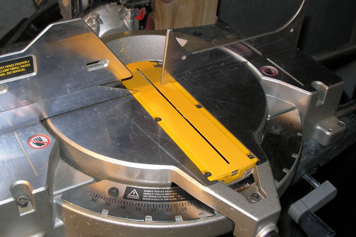

I found a new product which makes it really, really easy to add a zero clearance insert (or ZCI) to, in my case, a DeWalt 10" power miter saw. OH, not only easy to do but quite inexpensive! Important point that.
Anyways the product is from FastCap and they call it 'Zero Clearance Tape'.
[attachment=1]ZCI_ComboPic.jpg[/attachment]
It is basically a thin, tough plastic with double sided tape on the back. You simply cut the tape to size, peel off the protective layer on the back and lay it down on the existing saw guard. Then turn the saw on and cut a slot and ... you're done!
[attachment=0]ZCI_Done.jpg[/attachment]
So no more losing pieces through the huge normal slot (and, sometimes, kicking the remnant across the shop). When the tape gets chopped up, I'll just remove it and replace it with a new one.
Cost was $5 for a set of 6 strips. Each strip is 2" wide by 16" wide. I got mine from Highland Woodworking but a web search will turn up other sources. I intend to use some of the left over from my first strip to stick on the bandsaw to make a 'zci' of sorts.

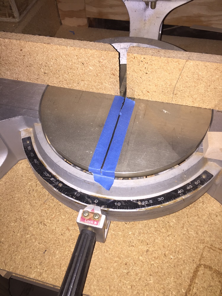

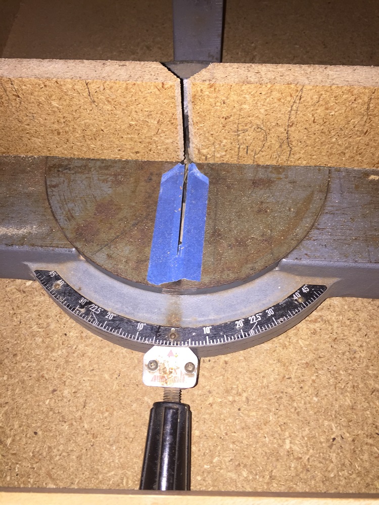

The old ZCI method
This is the method have used for years. Anytime you are going to slice a thin piece off just add a piece of tape.
