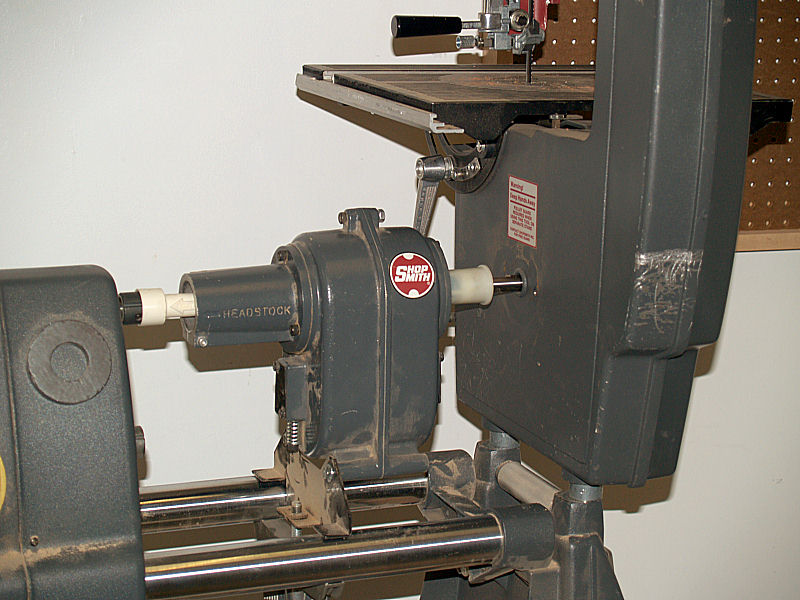

I was looking at the SS catalog for speed reducer. I do not see how you would connect the 2 together. The bandsaw and SS motor. Can someone post a picture or instructions? Do you need additional equipment to mount the 2 together?

O ye of little faith. Just switch the positions of the nylon coupler (inside the "snout") and the power coupling hub.
[ATTACH]1227[/ATTACH]
Will reduce the speed of the band saw blade all the way down to 300 fpm. Useful for the belt sander and strip sander as well.

Great! Figured there was a way but since I didn't want to order one before I saw it and all I had to go on was the SS catalog picture, I could not figure it out. that helps a lot. Thanks again.
