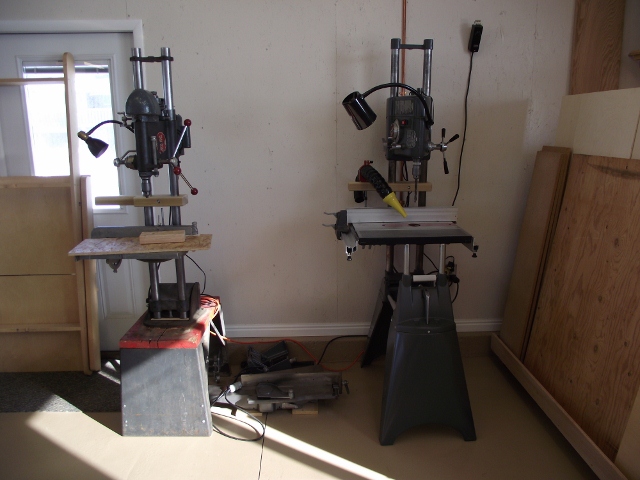

I did the Power Pro upgrade at the same time I did the double tilt. I bought a complete headstock so I had the old headstock as well as the parts left over from the double tilt upgrade. I used everything plus parts from eBay to make a dedicated drill press. The bench tubes are the 18" pieces left from making a shorty.
- DSCF1100 (480x640) (2).jpg (216.52 KiB) Viewed 5641 times
