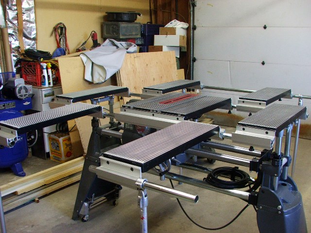

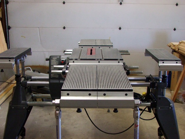

The green one from Germany. Can you say Festool? There I said it.
Of course you could spend a little money on your Shopsmith and do the same thing.
