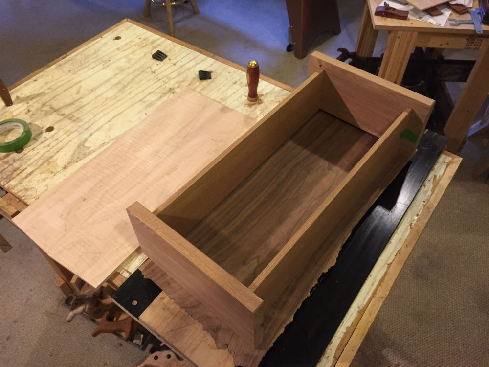

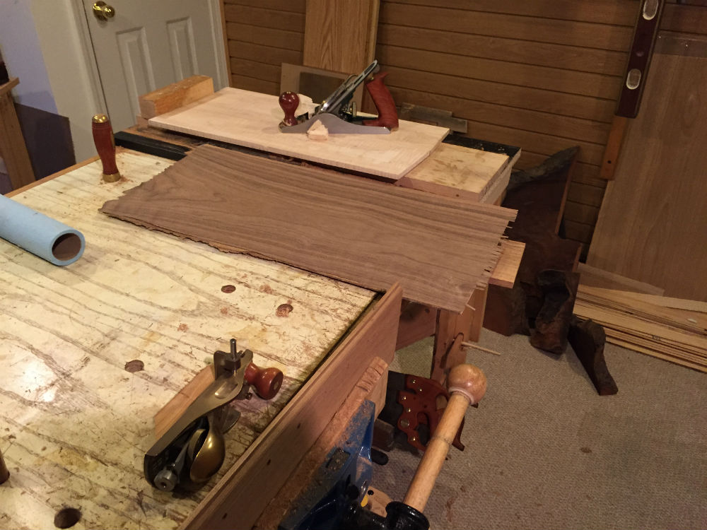

I've decided to make a 'feminine' type of gift since I was more generous to the nephews than the nieces this past couple of years. This will (hopefully) be a small wall-mounted cabinet. The plans are still in my head since I saw something I liked on the web, but my lumber pieces are different in size. Also I didn't want to spend my whole year on over-complicated joinery.

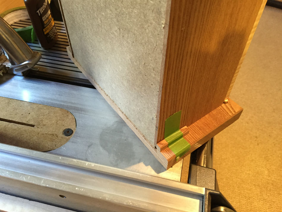

Here's a few of the pieces being prepared. I've been able to spend as much on hand-tools in recent years as on the Shopsmith. About a hundred dollars -- Rain Man. There is a bookmatched tiger maple piece (courtesy the SS bandsaw) being smoothed, some elm side pieces being rabbeted, and a rough back piece made of walnut veneer glued to the 'woven side' of some hardboard:
Cabinet Pieces.jpg (132.88 KiB) Viewed 5866 times

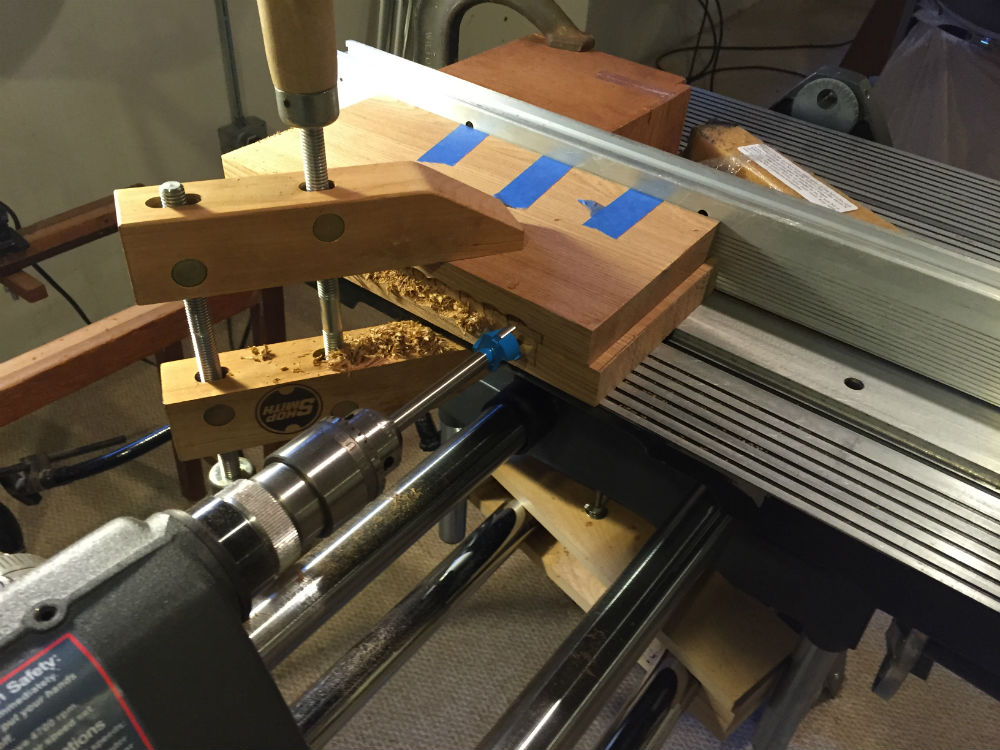

Top and bottom slabs will need some stopped rabbets. I ganged them together so I could hog out most of the wood with a Forster bit and the world-class horizontal boring machine:
More to follow later!

Today I did some trimming/squaring on the top and bottom slabs, and also ganged them together for boring some matched pilot holes through both. Certain holes for initial attachment of the side panels, other holes to accurately locate matched knife hinges at the top and bottom slabs....

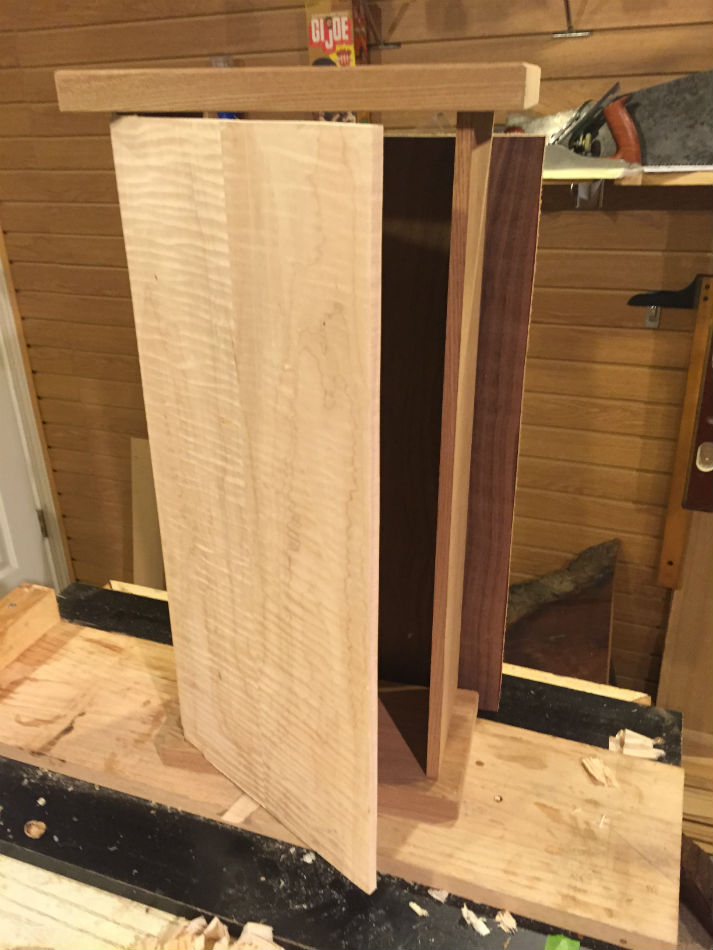

Proof of Concept
Post by nuhobby »

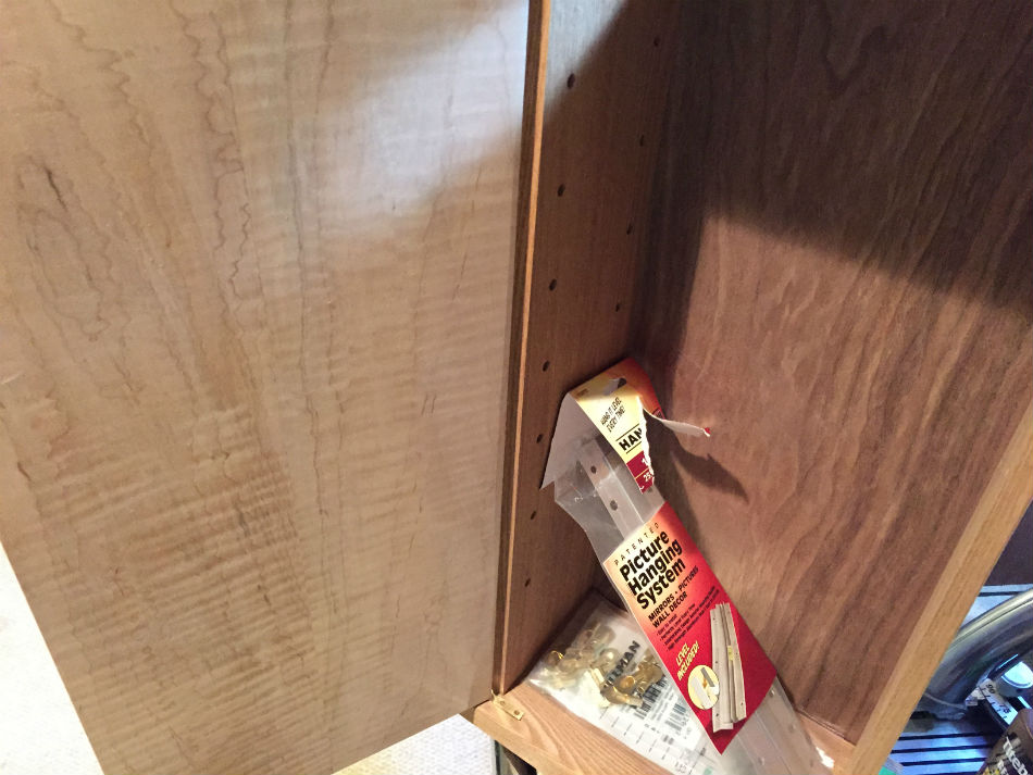

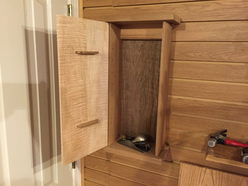

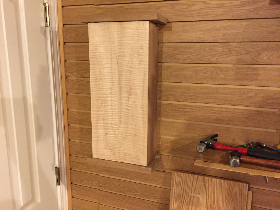

All along I wasn't sure if the "hanger scheme" would really work out, so I tried it out on the shop wall; luckily it does fine!
For the bookmatched front panel I have added some small buttresses which may or may not control warping very much, but they at least make me feel better. And the style of cabinet will tolerate some bowing on the door. After this stage, I have to make some shelves and also some latching & knob scheme, possibly magnetic:

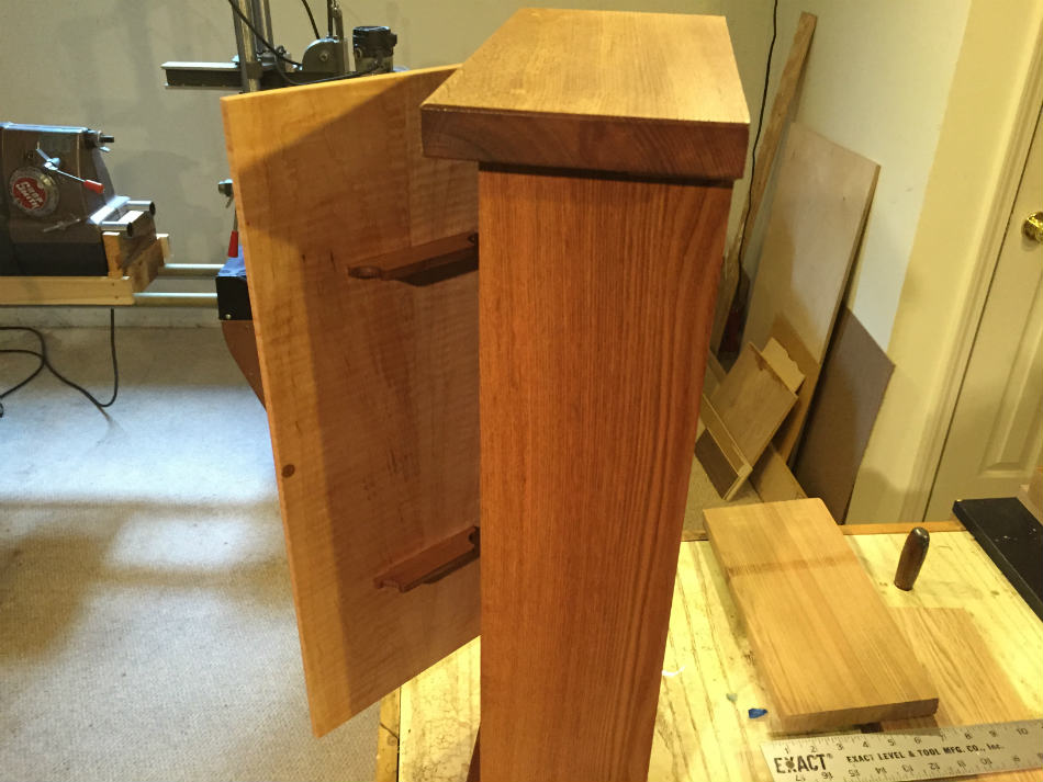

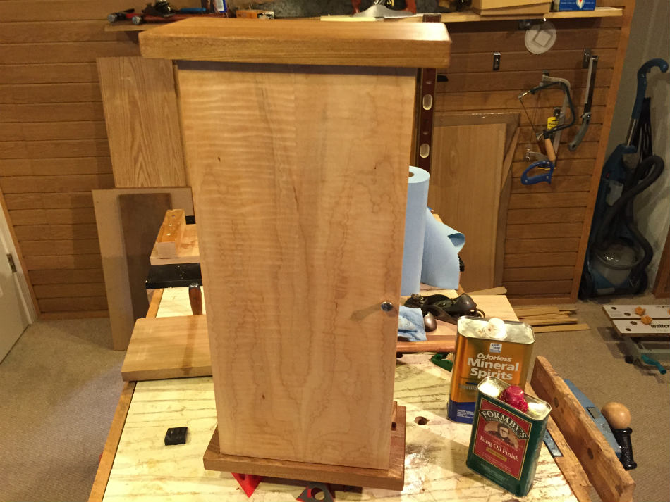

Not going that fast as work-life gets in the way, but some more progress has been made.
I found a couple of small but strong magnets in my piles of junk to serve as a "soft yet assertive" door-closing aid. As you can see, all the holes in the top (for attachment-screws and hinge-pilots as shown before) have been plugged with the same type of Elm lumber. This view also shows tiny coves in the elm stabilizer-pieces inside the front door; those coves were done prior to gluing with the Shopsmith and horizontal-boring with a Forster bit.
Also from my junk pile, an old Gerstner chest drawer-pull was buffed-out on my Shopsmith and attached to the front door. Then I've applied my favorite indoor finish which is just a bit of the Formby's gloss formula, which I will knock down with steel-wool and wax over:
Chris
