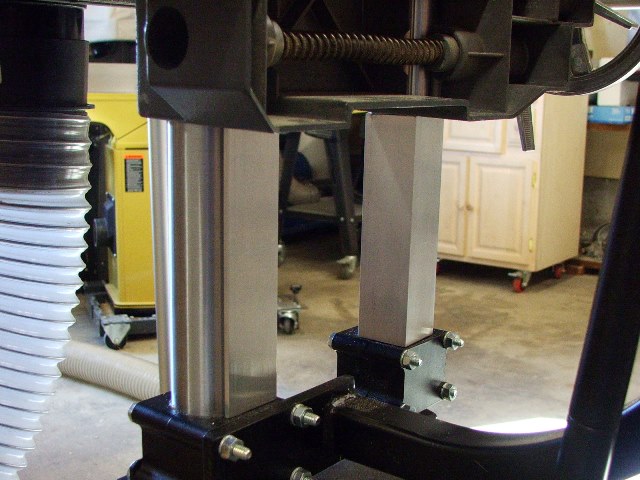

Or, you can block and brace the carriage. A New Jig 'Necessitated' By My Shorty

This was my solution to possible slippage although I never had any. Plain drilling should not make the table move. I used it for mortising along with the telescoping legs on the front of the table (yes Dusty I know you don't trust them, not sure why, but they work for me). Just two pieces of aluminum angle iron that set the table to the "optimum" height and the telescoping legs on the front of the table. Rock solid.rpd wrote:This thread covers some possible solutions to you slippage problem. Main table slipping when in drill press mode
