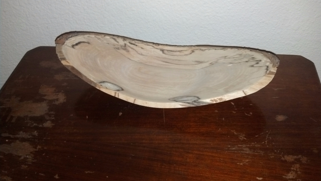

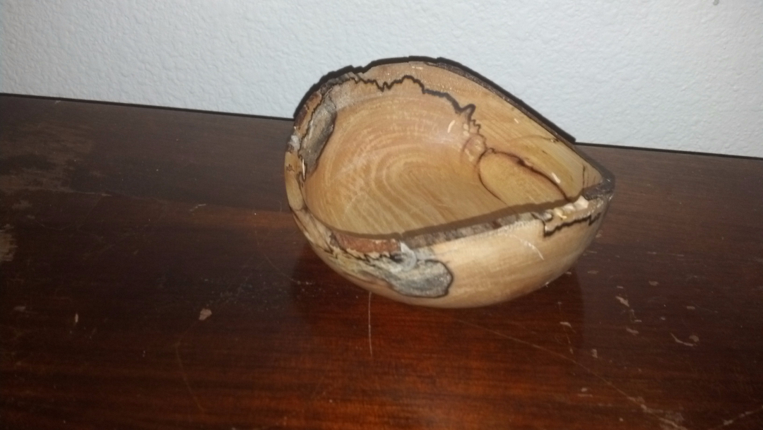

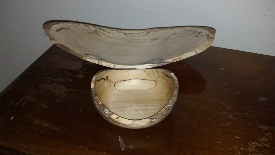

I joined the local wood turning club and this is what they demoed this month. I sharpened my tools on the strip sander and it works better than the system I was using. I'll stick with it. Sharp tools make it fun!

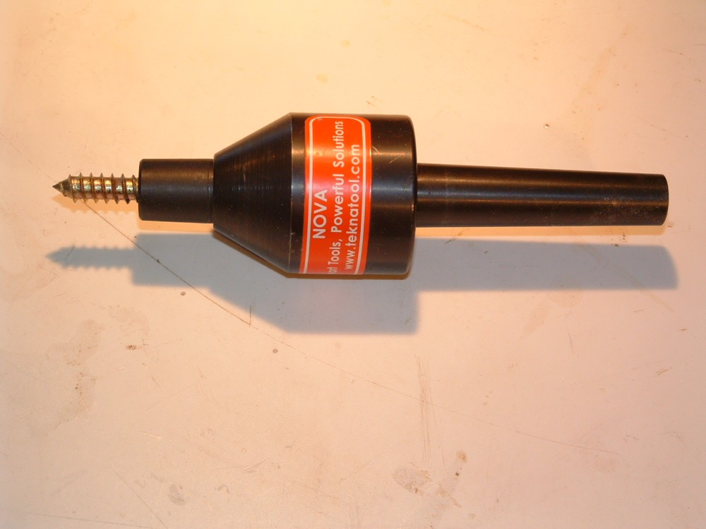

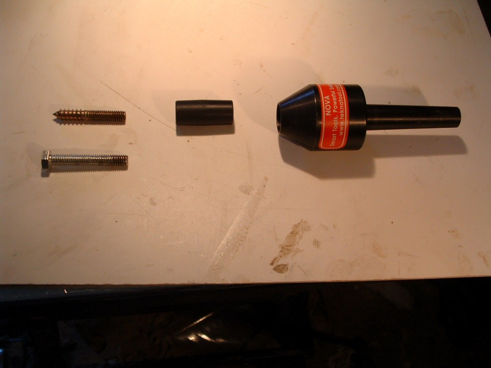

There are a few possible solutions.
You could use a Morse Taper Extension Socket
If you have a Oneway or a Nova live center you could make what Cap'n Eddie calls a soft touch.
[youtube]https://www.youtube.com/watch?v=_u4fipmLQr4[/youtube]
[youtube]https://www.youtube.com/watch?v=wwO363dXHxE[/youtube]
For the Nova live center you could use the screw adapter or a 5/16 - 18 tap and a cut off bolt or bit of all thread.
