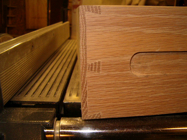

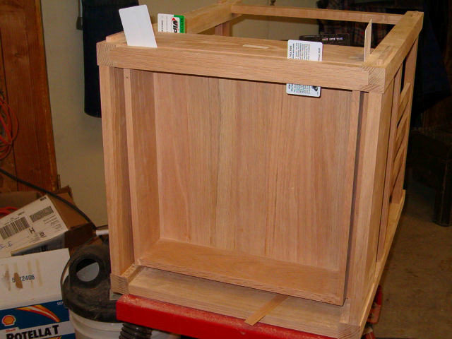

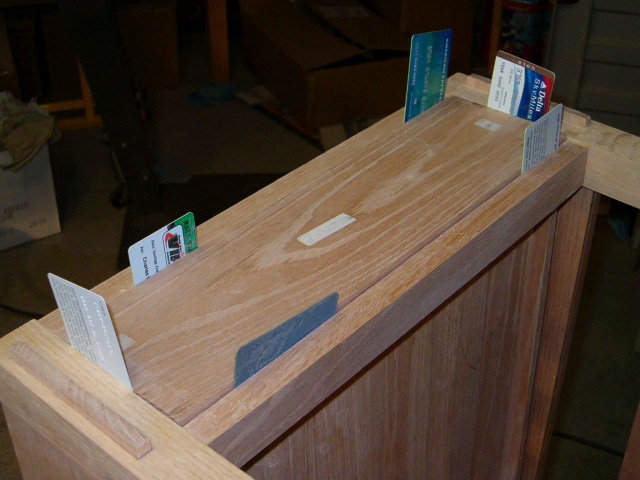

Had an interesting week! Finished messing with the dovetails on the drawers, serviced the Mark V while I had my very first shop visitor (matajugador) - it was fun! - Guessed right, and was able to sharpen 'throw away planer blades' rather than discarding them; prepared 1/4" oak boards from scrap and glued them up to make 16" X 17" drawer bottoms (8 or 9 boards per bottom).
After assembling and gluing up the drawers - started sizing the drawers to fit the openings. I have to remove a little more than 1/16" from sides, top and bottom. This is the only way I have figured out how to make drawers with a 16th of an inch on all sides of the inset drawer fronts. The procedure I had been using called for first making the rear of the drawer fit loosely then keep trimming until the fronts are just right. This time I have elected to use the conical disk sander for the whole job! The disk is just wide (tall) enough to sand the entire sides at each pass. Also spent a bit of one day diagnosing and worrying about the motor bearings on the DC3300.

P.S. Correction to above: There should be about 1/32" spacing (gap on all sides of the insert drawers. Not 1/16th as said earlier. Those simulated credit cards I get in the mail every week work real good for spacers. I have a collection of them.
Top view of drawer fitting.jpg (114.14 KiB) Viewed 8419 times
Closer look at the joint.jpg (131.68 KiB) Viewed 8409 times

Chuck, that is awesome stuff. You have an eye for the details, and a creative flair for the use of Junk mail!:D
I'm going to have alot of trial and error before I can achieve results like yours.
I feel sorry for the material I am going to practice on.:o
Thanks for the pictures!

Chuck how did you cut the dovetails? By the way nice work also.

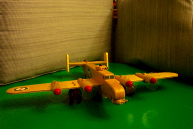

I find myself in the middle of a DIY project of redoing our Family Room. This project has taken on a life of its own and it has grown mightily in both scope and complexity. A few weeks ago I needed a sanity break and went down to the shop. I didn’t have the time or the courage to start a new project, certainly nothing like Chuck’s beautiful dovetail joined drawers, so I grabbed an item from my “mending bin” to work on.
[ATTACH]1271[/ATTACH]
A couple of new vertical stabilizers, some missing dowels replaced, a good dusting-off, and it was ready to go back on the toy shelf to await the next young visitor. Unfortunately, the toy shelf is disassembled. It is supposed to be in the Family Room closet. If (I mean when) the Family Room project gets completed, I’ll try and post a photo.

I wanted to answer Scotts "how" question, but first, I want to endorse the post by Dennis.
Any project that is undertaken by a woodworker is a good project. Be it a book end, a single shelf, a set of shelves, a book case, a picture frame, a cabinet, and on & on, all the way to a copy of an antique secretary decorated with carvings. There are a few woodworkers that produce pieces that make us simply amazed at their vision and skills. Most of us, however, are more common - most of our projects are made from other's plans, or ideas. The important part is they are our projects! We take pride in the finished object, regardless of the complications in making it. One thing that sticks in my head is the old saying, "The better craftsman is the one that can better fix his mistakes". I can never get over the thought when I see one of the marvelous projects, made by a 'Master' - "... wonder how many mistakes he fixed?"
On to the tables I'm making. These are from the plans, pictures and instruction in a book from Popular Woodworking. My Daughter said, "Can you make me two of these?" Of course this quickly reaches the top of the list! These tables had dovetail joints. I'd never made dovetails in anything before, so these were a challenge, I didn't know how to solve. The guys in the book used a router table and what looked like an Incra Jig. I thought about the router table I have, and even thru dovetails using the bandsaw.
I decided to try my luck on the OPR. After making two trial joints, one with 4 pins and one with 3 pins, my wife and I decided on the 3 pin type.
I stacked the four drawer sides on the OPR table (in horizontal mode) and cut the tails by raising the table so the dovetail bit passed through all four boards. Using the tails as a template, I marked the pins on the drawer fronts with a sharp pencil. Then, I used the OPR again in horizontal mode with a straight 1/4" bit and routed (hogged) out the space in between the pins, using stop bocks to avoid routing into the pins. Next using chisels, I trimmed out the slope of the pins and also did a little trimming on the bottom of the area that was routed. (I was cautious in the hogging operation not to rout too deep, so there was a little trimming needed) Incidentally during the 'hogging' operation, I used the adjustable stop collar to control the lifting of the table.

Nice airplane, Dennis. Is it a DeHaviland?
