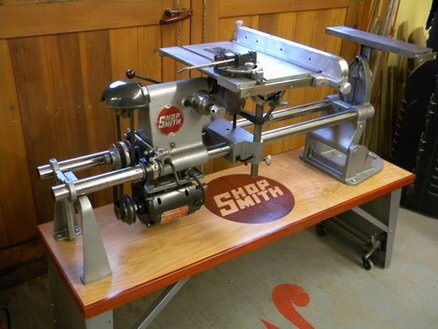

This has to have been discussed to death. Can someone direct me to a thread or just answer the question: Can you re power your 10ER with the Mark V motor you removed to install your PowerPro upgrade? My old ER would love a new motor and it would make me feel a little better about spending the money if I was getting some "value added". I assume that at least some creative mounting would be required. I'm more interested in whether it is just physically too big or some other deal breaker.

That's the kind of thing I was looking for Ed. I wasn't aware of the speed differences. Could I not reduce the circumference of the motor pulley by half?
EDIT: I just looked at the photo again . Looks like the belt is already on the smallest step. Smaller may not be doable.
Re: Re powering 10ER
shipwright wrote:That's the kind of thing I was looking for Ed. I wasn't aware of the speed differences. Could I not reduce the circumference of the motor pulley by half?
For the speed changer to work at both ranges, the belts are rearranged. The motor pulley requires both the smallest and the largest pulley.(as well as the upper pulley)
Your pix shows it in lo range.
