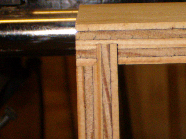

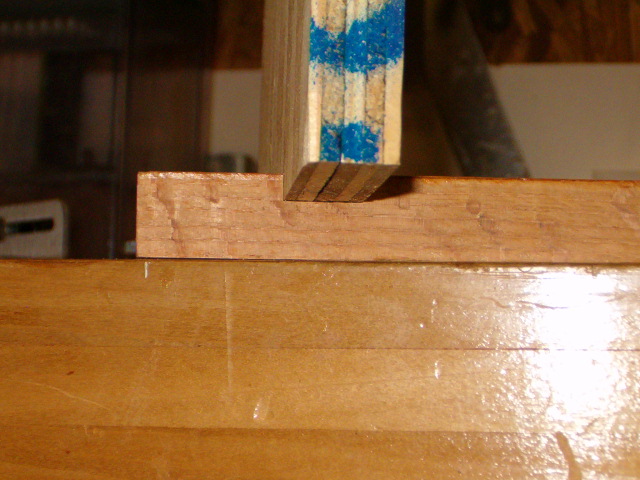

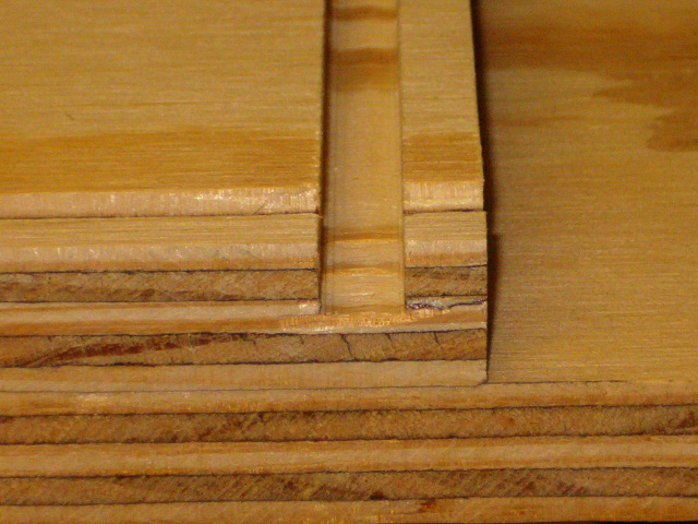

Hi Gampa and Bruce! Just got to add this into the mix. Years ago I bought a wobble Dado from Shopsmith. It works just fine for me, even cutting across the grain on plywood. At 3/4" it has a very smooth, flat bottom. I've compared my dadoes to those pictured in magazine tests of the expensive models. To me the edges and the bottoms look the same.
I hesitate to recommend the wobble to anyone. That could be likened to recommending a Shopsmith Mark V 520 to a group of woodworkers who are shopping for Laguna tools.
Anyway, here is 3 photos of the results of the wobble.
flat bottom.jpg (119.88 KiB) Viewed 15327 times
3 eighths wobble dado.jpg (162.42 KiB) Viewed 15328 times

Nice results, Chuck. I used to have a wobble dado years ago (or I borrowed one) and did not get the flat bottoms that you show. I don't remember who made it. Now they have dado clean-out router bits that will put a nice flat bottom on a dado if you don't get one with your blade.

The Dado's from your wobble blade sure don't show any problem. I have often wondered about the bottom being cupped on wobbles. It didn't make any sense to me. If you bent the blade then I could understand there being a problem but if the blade is just held at an angle I don't see there should be any cupping the diameter is not changed. But I have been wrong before and I'm probably wrong now however your pictures seem to prove otherwise.

Great results! Looks way mo better (thats all the Hawaiian I know) than anything I get from my stacked dado.
