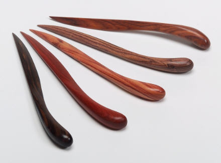

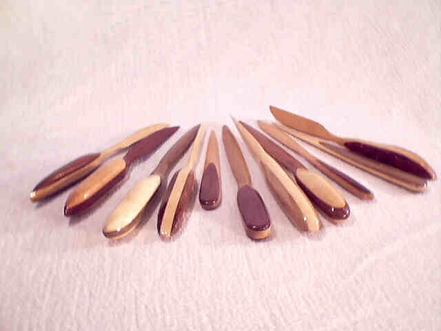

And tried a couple like these before I figured out I was not a very patient carver
But a while back ran across these in a search and thought they were cool looking so may try something like this
Not sure of the quality of the Penn State kits so have not bought one to try, but I think I like the idea of a non-metal blade so will stick with all wood.

Ben, Those letter openers are really cool.
I too, prefer ones without metal.

Real nice job Ben.... Excellent work...... Beautiful.
