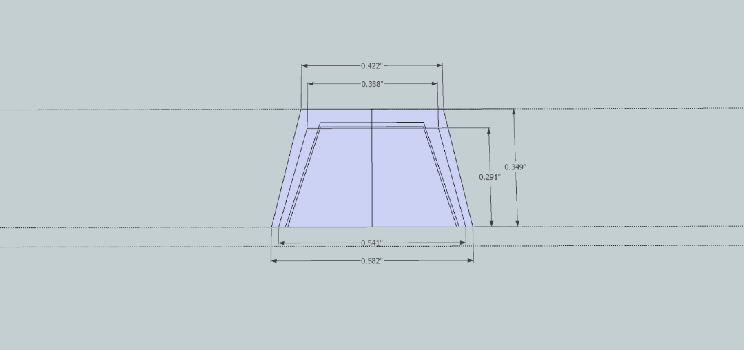

I am back to step 1 with the belt replacement. I needed information that I could not get with the belt installed.
The attached drawing shows the profile of four belts. The two that are dimensioned in the drawing are new. The larger one being the belt from BTW and the other an unused (unmounted) belt from Shopsmith. The other two are used belts that I retained after being replaced just because I do that.
The belt from BTW, it has been stated by BTW, was manufactured according to original Shopsmith specifications.
I'll post the belt lengths (as a PS) a bit later.
- belts with dimensions (Large).png (42.79 KiB) Viewed 2834 times
