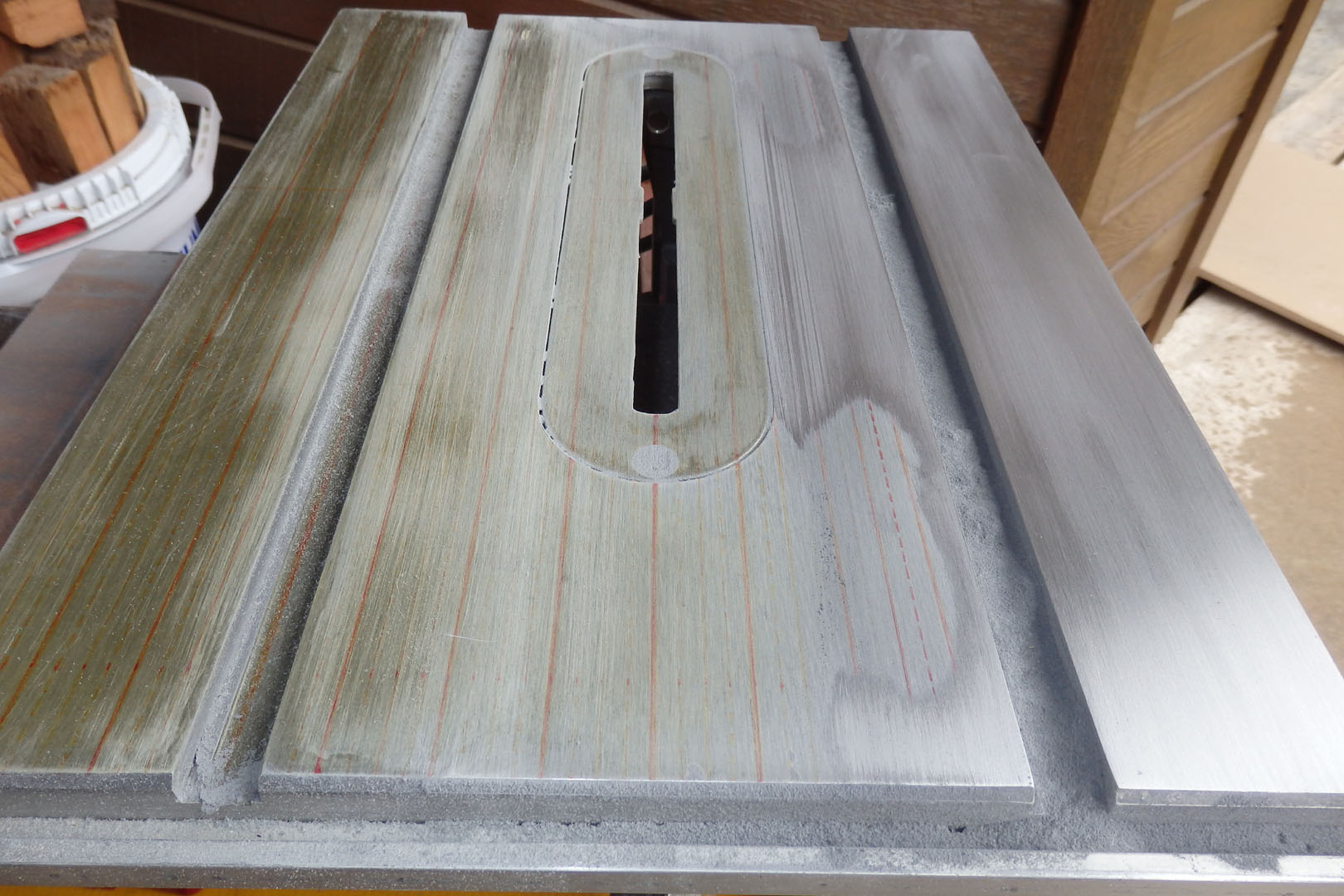

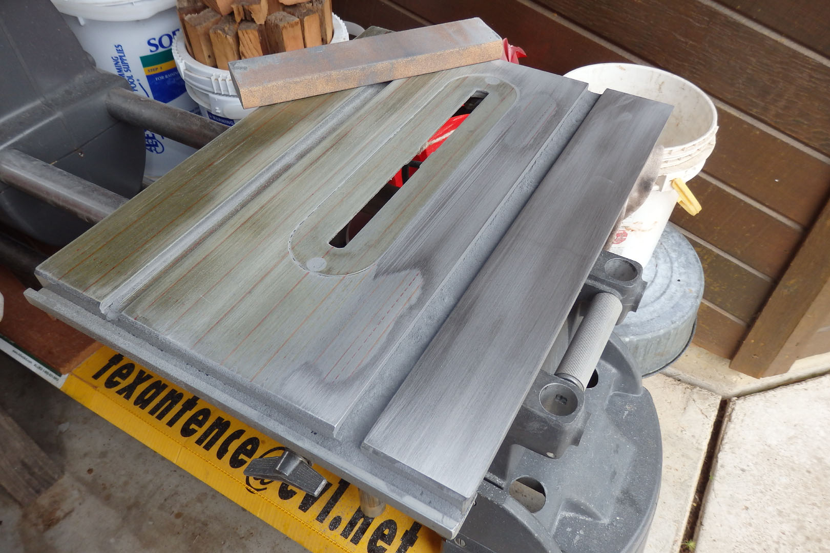

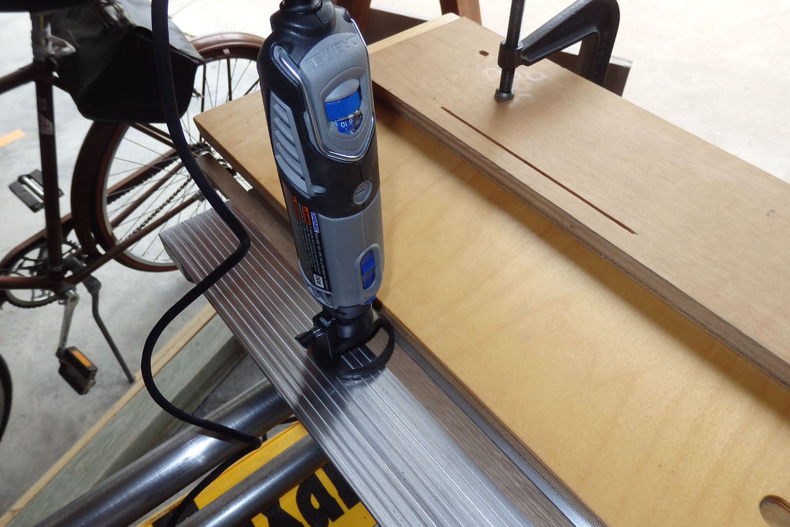

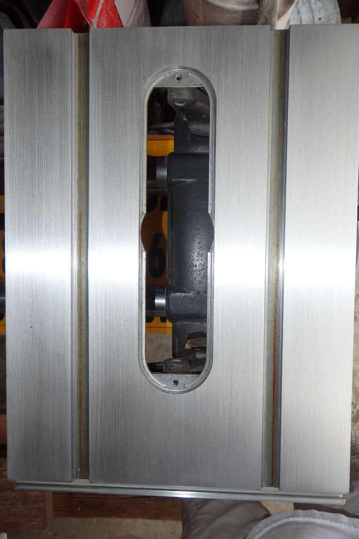

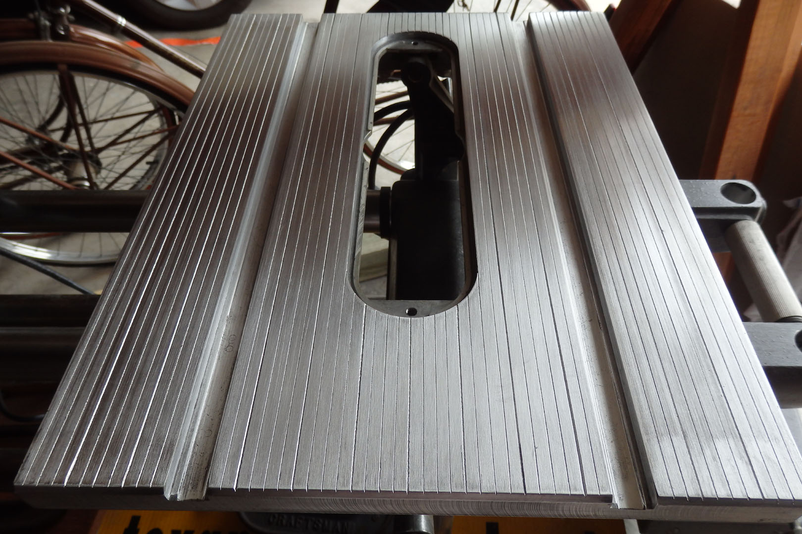

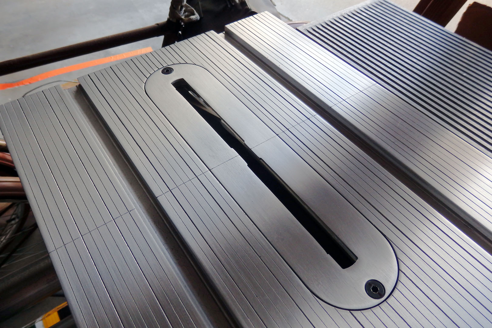

FINAL METHOD: Engrave lines in table. Table first sanded to remove old varnish, lines, and to "flatten" table, which sanding soon revealed was needed. Started with 60 grit Aluminum Oxide wrapped around 12" long block of wood, and progressed to 280 grit. Next, using Dremel tool with 1/8" 90 degree carbide CNC bit and clamped straightedge, route or engrave lines 1/4" apart. Whole inch increments were routed more times (50 passes each) to give deeper/wider lines. Other lines routed on average 15 passes.

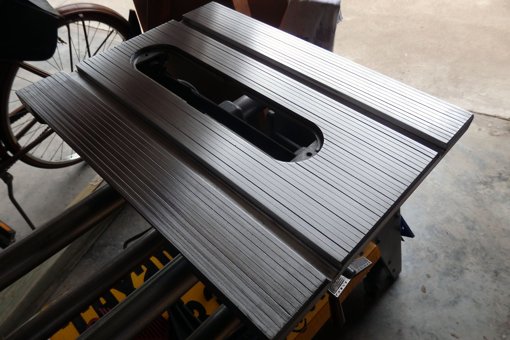

- Sanding in progress
- P5121541a.jpg (286.7 KiB) Viewed 4015 times
- P5121546a.jpg (267.92 KiB) Viewed 4015 times
- After sanding
- P5121548a.jpg (147.89 KiB) Viewed 4015 times
- Routing process
- P5141552a.jpg (266.64 KiB) Viewed 4015 times
- 1/8" Diameter 90 degree V Shaped Solid Carbide CNC Bit
- P5141555a.jpg (180.99 KiB) Viewed 4015 times
- Finished
- P5141562a.jpg (327.92 KiB) Viewed 4015 times
- Finished
- P5141564.JPG (319.3 KiB) Viewed 4015 times

Interesting. I guess the question is, what are the lines parallel to, exactly? The miter slot?
Re: Engraving Guidelines in 500 Main Table Top
I would assume that but it does not really matter so long as it is those lines that are used to align the table to the blade and the rip fence to either the table or the blade.
I like what you have done and I would like to have one line done on my 510/520 table (the center line). I have often cussed Shopsmith for now doing that.

Yes, lines were engraved parallel to miter slots, or as close to parallel as I could. Between measuring and marking at front and rear of table, setting guide the proper offset distance from those marks to center of bit, I'm sure I'm off a little, but it saves me handling a ruler one more time to get fence about where I need it. Table is adjusted so that blade is parallel to miter slots.
After initially posting, it dawned on me I forgot to cut one more line, perpendicular to miter slots and centered on quill. A corresponding line on my fence and layout lines on my workpiece helps align bit when using horizontal boring function. Fortunately, I hadn't yet removed the bit from the Dremel tool, so not much effort to truly be finished.

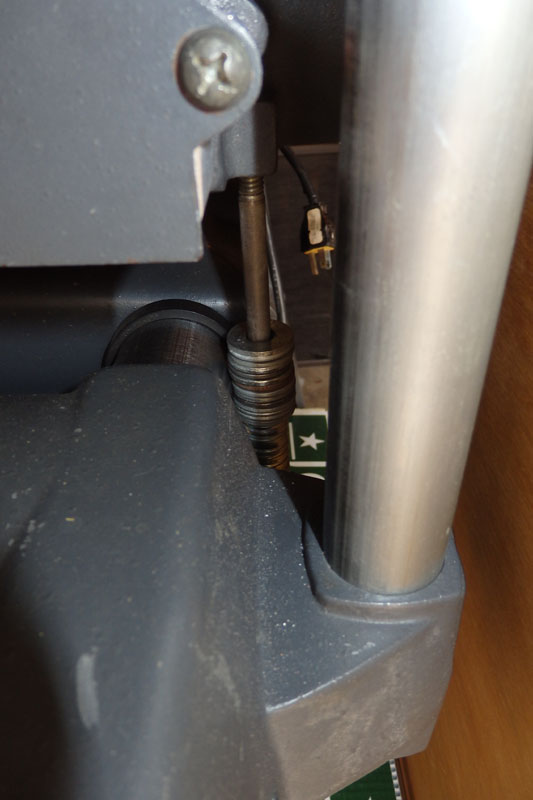

Yes, but ... only with a standard 1.25" arbor. With my 5/8" arbor, no. And with my modified lower saw guard, washers on post interfere with rubber stop, so I routinely extend the quill a 1/2" or so anyway before doing any sawing. Then I have some adjustment capability, by extending or retracting quill, for exact width of cut.dusty wrote:I'm curious! Does the left side of the blade align with the center line of the table insert when the quill is fully retracted?
- Washers were added to ensure top of guard parallel to table
- washers as spacers.JPG (66.9 KiB) Viewed 3886 times
