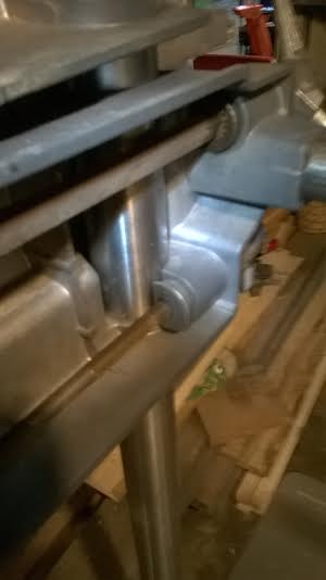

Re: What do you do, when a headstock is stuck on the way tubes?
The underbelly of my stuck Mark V
- SSS.jpg (13.59 KiB) Viewed 3512 times

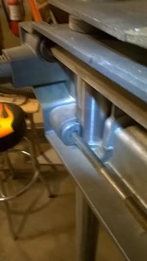

Here is the other side!
- SHOPSMITH.jpg (11.75 KiB) Viewed 3511 times

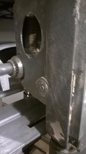

Threaded end.
- SS8.jpg (13.21 KiB) Viewed 3510 times
And those photos that I supplied were the table wedges and not the headstock wedges. Dang Rookie, mistake
