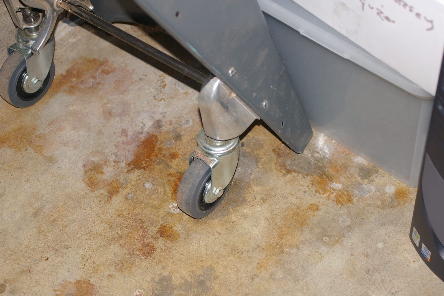

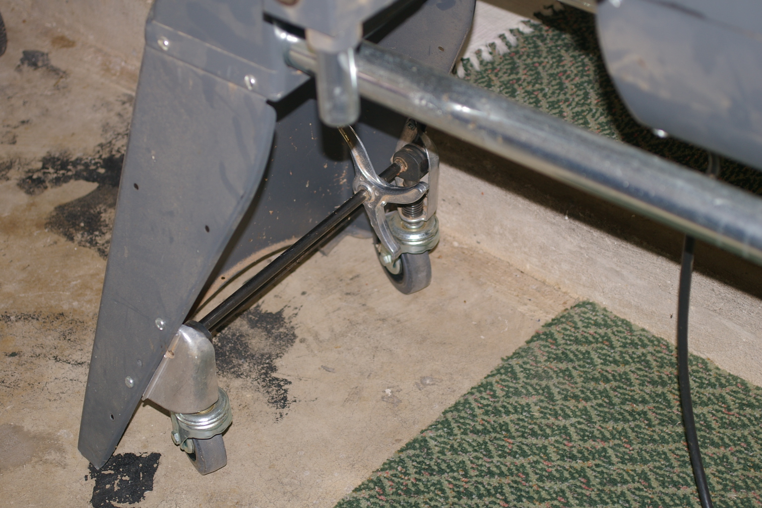

I don't have a clue what the problem is with the casters yet. Do to medical issue can't get down to remove one for inspection. I really like the setup if it wasn't for the sloppy way they operate. 4"urethane wheels. The machine really moves around smooth as glass.
I have to ask because these do not look like the Shopsmith wheels that I have seen. Are these from Shopsmith and if not, are you certain that the stems are the correct diameter and length (I am thinking about your description of the problem).

It does look as though the operating levers are much closer to the inside of the wheels than are mine. There is at least one post about that on the forum. Some folks have relocated those levers to make them easier to access.

I don't believe the wheels and shafts are SS. However, the wheels and shafts are not the problem. The problem is the foot lever and the shaft the lever is mated to flop all over the place. When you raise and lower the foot lever with your foot instead or remaining in that position, the lever will flop back up even though the wheels will remain either up or down. Hell!, I think I just confused myself.

The foot lever, on mine, does not "flop around". It remains pretty much in a given position relative to the lift level that has been selected. I don't know what would make it do otherwise. I'll have to pull a caster mechanism and look to see what I think might cause your problem.
Does the foot lever move on the shaft to which it is (supposed to be) attached without the machine moving either up or down? That foot lever should be pinned solidly to the shaft.

SPT(bandsaw) flop. Is the lock adjusted so both ends of the locking screws are pressing against the mounting tubes without the ends of the knurled handle touching the casting? If not, only one end is clamping the tubes. To adjust the locks, loosen them until they will slip out completely. Notice the screws(they have square heads). One will have left handed threads. Run the screws in to the handle as far as they will go. Then back each out the same amount. On a later 510 that would 1 to 2(or more) full turns. The objective is for them to just slip into the slots in the end casting. Rotate the knurled handle until the screw ends just begin to enter the bore(as seen from the top of the bore). Insert the bandsaw and tighten the handle. When tight, neither end of the aluminum knurled handle should be touching the end casting and each end clear it the same amount.
The casters mechanism is unusual. The casters themselves are not OEM Shopsmith. They appear to be the newer version(retaining screw holes at the end of the camshaft). They have been remounted to the legs. I cannot tell for sure, but the cam in the second pix is in the 'first raised' position while the legs appear to be still resting on the floor. That implies the caster mechanism is mounted to the legs too high. That would allow the crankshaft and foot pedal to be 'loose' at the 'lowered position'.
When positioned to the leg properly, the first cam position should raise the SS off the floor close to 1/4". The second cam position should raise the legs close to 1/2" off the floor. At the lowered position, the legs should rest firmly on the floor. The caster wheels may rest on the floor, but there should be no weight bearing on them.
Yes some things are different on the later parts, but not to the degree described in the first post.
I am guessing the PO got casters 'elsewhere' and used SS hole mounting directions[which are suspect themselves especially the initial version]. They may be from Bill Mayo and improperly drilled.

JPG wrote:They may be from Bill Mayo and improperly drilled.
I don't think you meant to imply the way I read it.

I meant the PO mis-drilled them, not BM!beeg wrote:JPG wrote:They may be from Bill Mayo and improperly drilled.
