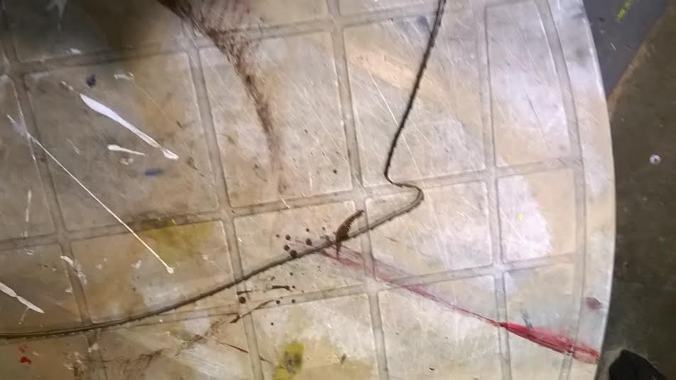

And I found that replacement is a breeze! Not sure why the blade broke. I was only cutting SurePly. Nothing extreme. But the breakage seemed pretty severe.
You should have seen the blade. It had a "Z" in it, right above the table!

Can you post a pic? Maybe someone can pinpoint the cause.

By a "Z" do you mean it had a sharp angular bend? When I have done this it was caused by backing out of a cut and in the process twisting the wood a little too much. Once crinked (creased) a blade may hold on for a while, but it is weak there and will eventually break.

- BentBandSawBlade.jpg (38.01 KiB) Viewed 2625 times

Hi Extra! Good photo of a double bend. If that is the damage and there is no actual separation, you can fix it - at least temporarily. Just bend it as straight as you can with your fingers. After getting just a slight double bend, lay if on your bench and work it some more to get it straightened.
This looks to me that it happened when the blade caught on the upper or lower blocks while not having enough tension.

I think I now know why is broke. I think I had the shoe of the saw, to high!

The arm and guard should be say no more then a 1/4" above the workpiece, if you had a couple of inches then I can see how the blade could have gotten to that shape.
