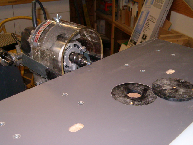

Well, despite the best efforts, the table (packed separately) has a new hairline crack along the middle. The crack in not completely through the board. I looked up the price of a replacement table. The part number, 515495, crosses over to 515599. the price? Eye, ye, ye...$289.10
Anyone have any thoughts to a repair or any other ideas? For some reason FedEx Ground and used Shopsmith products delivered to my address often suffer damage. I had a power station that wasn't as well packed and the heavy motor bounced around & took a toll.

- overarm_crack.jpg (29.55 KiB) Viewed 10333 times

Now to your table. you say a hairline crack. I am visualizing a crack on the top surface layer only. (don't know if it is horizontal, vertical or at an angle)The table center is some type of MDF, so a lot would depend on the location of the crack and its extent. I don't know the material of the outer top skin, but is is about 1/16" thick. If the table was bent to cause the crack you'll have to determine if the table is still flat and if the center core has been damaged. The melamine may have been damaged a bit. Hope not!!
If the table is flat and it will fasten to the Mark V main table and wood will move across the crack with no impedance - then you probably are in good shape. When waxed, this is the slickest table I've ever used!

Hi Tony! Your table is quite different than mine. I see you have the stand alone version of the OPR. Nice photo showing the cracks. Looks like the damage happened with the center plate wasn't in place, and the 'T' track acted to stop any further damage.
If the table is flat (and it looks that way) you probably don't need a fix right away. Maybe someone here can tell you about a sealant for the cracks. You can probably seal then sand it smooth.

I agree with LDH. You can probably reinforce the cracks from underneath by adding a plate. The rear would be just to prevent anymore movement. Hopefully reinforcing would even the table in the front. If there is not any catching when going over the crack you should be okay, If not, sand it even and wax the table. I doubt you can get another table from SS. If you didn't get a manual I can send you the part number.
Thanks gentlemen for your responses. I can get a table alone for $175 plus tax plus shipping from Poe Avenue. A member on another user group offered me his for $150. I have filed a claim with FedEx and my plan is simply to repair what I have.
I learned a trick from an old model airplane builder some years ago. He took a 2-part epoxy & mixed it up. Then he added denatured alcohol to the point the epoxy became a liquid. Then he taped off a crack & poured the epoxy to where it slightly overfilled the the crack. It dried & only a light sanding was required.
I learned this trick about 20 years ago. The fortunate part of this problem is that the hairline cracks are on the top surface of the table. Simply applying downward pressure closes the cracks up. A metal plate will provide enough support that should prevent any flex.
