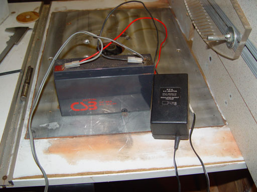

I canabalized a Black & Decker 6v cordless screwdriver and mounted it onto my Ryobi 600i. I installed 2 micro switches to act as stops so the motor don't twist its self off the screw thread.
Absolutly brilliant with my biggest bit a 2" straight cutter, It retracts just below level and fully extended, is far enough above the table that I can get my spanner on the collet to change the bit.
Parts I used - 2 x micro switches, 1 x on off on switch for forward and reverse, 1 x momentary-on switch, 3 x Jubilee (radiator pipe) clamps, 1 x 6v sealed battery and the battery charger for the cordless screw driver. All parts lying around the shed except for the reverse switch - total cost - $5.99 MAJIK.

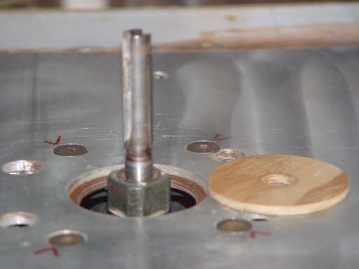

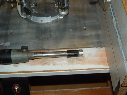

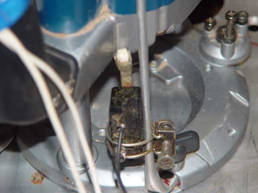

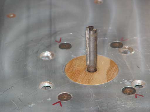

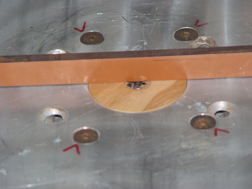

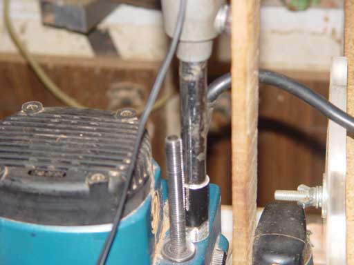

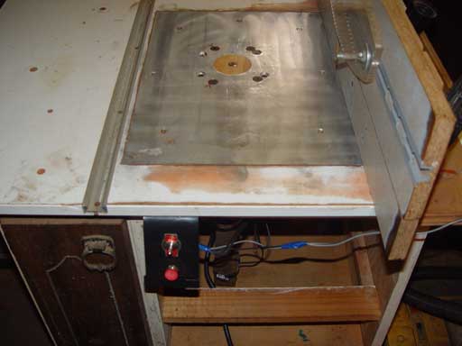

Here are a bunch of photos of the workings to get the motorized lift working.
They show the total travel from over 2" above the table - able to change bits from above table - and the bottom most position - 3/128s below table.
One micro switch is screwed into the hollow handle (non-power side) and uses 8mm ali pipe as a stop. The other switch is clamped onto the R.fence holder using 8mm ali pipe - this one uses the body to stop retraction.
Some of the cordless screwdriver is removed to reduce total height of the unit. This was where the batteries were.
There is a 1/2" pipe that accommodates the routers height adjuster (this takes up overall height). This is mated to 9/16 id ali tube and captures the nut to drive the height adjustment.
All wiring was twisted together for the 'dry run' and when all all checked out okay then soldered. Insulation tape then covered the joints.
It is not very pretty but it works. At this stage there is no incremental stops this is taken care of with the momentary on switch on the front panel - red button. This will be run thru a foot switch later.
5 photos this post - 4 next one
Regards
Sandy
Regards
Sandy

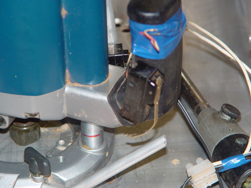

photos continued
Biggest drawback would be the extra depth the unit takes up - I lost 1 drawer in the making - not really a problem. The router table is a converted bathroom vanity unit - doing it on the cheap.
Regards
Sandy
