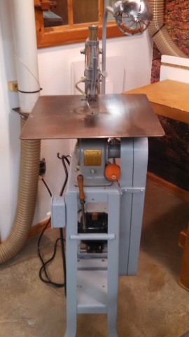

The stand was wired with a switch, plug and wire from another era. I replaced it all with grounded wire. I loved the old switch, but it had to go. The rear wheels were solid rubber. I spun them on my lathe and trued them up and buffed a shine on them. They look new. I also put new rubber paws on the front legs and leveled the stand.

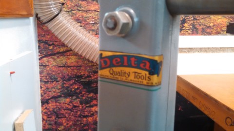

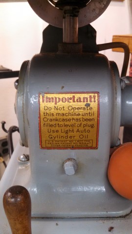

The oil tank on this saw has an access plug beneath a warning decal to not run without oil. I pumped the old out - it was red with age - flushed it then added 5W grade oil.

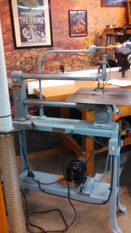

I painted the stand, carefully masking the decal. It had been painted once before, but needed to be touched-up. I painted the light pole and pin-stripped it with green on both sides.

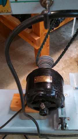

I mounted the motor and used a link belt. I will probably replace that as I have found they can eat pullies.

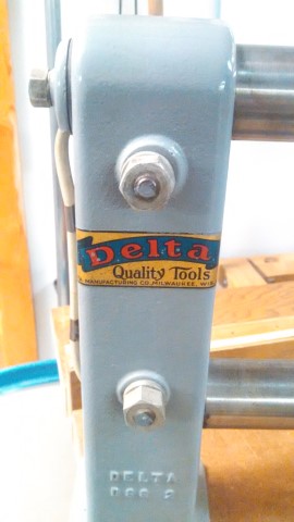

All I had to do to the saw was give it a coat of Johnson's Paste Wax like I use on my SSs. Here are a couple of shots of the original decal.
