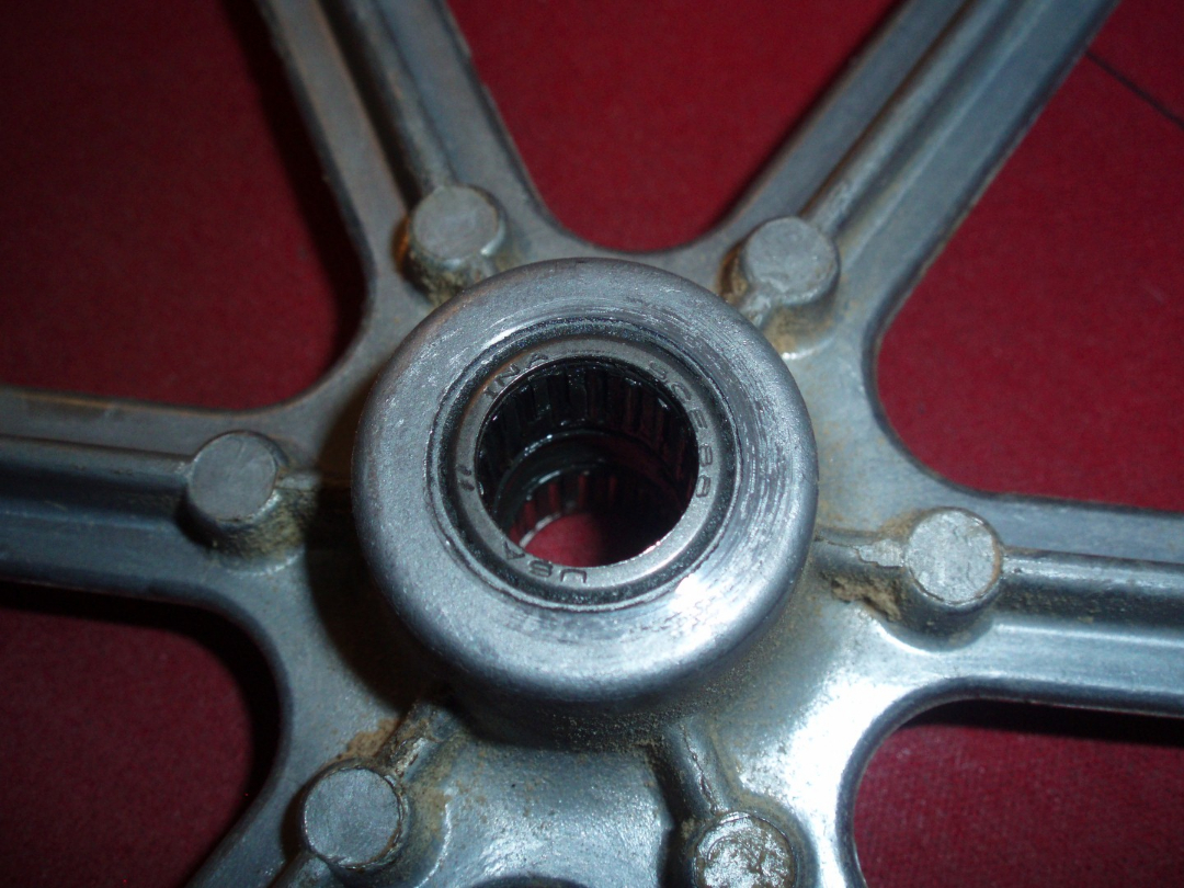

The bandsaw upper wheel requires 2 B88 needle bearings. These are available from many sellers on Ebay. I found that a bearing installation tool and a hydraulic press is required to remove and install this needle bearing. The needle bearing outer case is a thin metal and be easily bent/distorted.
Re: Bandsaw Upper Bearing Part Number
Two Needle Bearings? Do they install from opposite sides or are they pressed in from the same side (which side)???billmayo wrote:The bandsaw upper wheel requires 2 B88 needle bearings. These are available from many sellers on Ebay. I found that a bearing installation tool and a hydraulic press is required to remove and install this needle bearing. The needle bearing outer case is a thin metal and be easily bent/distorted.
Yup. Two bearings. Readily visible if one looks. It also appears that they must both be installed from the rear. If you look closely (if the images are good enough), you can see the part number SCE88.
Sure wish I could get good images like reibles'.
- Upper Wheel Bearing Front (Large).jpg (861.44 KiB) Viewed 5546 times

Nothing wrong with yours!!!!dusty wrote:Two Needle Bearings? Do they install from opposite sides or are they pressed in from the same side (which side)???billmayo wrote:The bandsaw upper wheel requires 2 B88 needle bearings. These are available from many sellers on Ebay. I found that a bearing installation tool and a hydraulic press is required to remove and install this needle bearing. The needle bearing outer case is a thin metal and be easily bent/distorted.
BTW they are getting better, so you are obviously trying!!
I only replaced the set of needle bearings on 1 bandsaw. I pressed the new needle bearing in from each side of the wheel. I did drill and tap a hole for a zerk grease fitting on this one before installing the needle bearings but decided that was not really needed again as I saw no real wear occurring on the dozens of arm shafts of the bandsaws I serviced. Removal of the upper bandsaw wheel to allow the use of a pipe on the shaft to set the proper upper wheel offset provided me a time to grease these bearings.

Thank you but the images that reible posts are much clearer, much more professional.JPG wrote:Nothing wrong with yours!!!!dusty wrote:Two Needle Bearings? Do they install from opposite sides or are they pressed in from the same side (which side)???billmayo wrote:The bandsaw upper wheel requires 2 B88 needle bearings. These are available from many sellers on Ebay. I found that a bearing installation tool and a hydraulic press is required to remove and install this needle bearing. The needle bearing outer case is a thin metal and be easily bent/distorted.
Sure wish I could get good images like reibles'.![]()
I do get better images that in the past but there is great room for improvement. I have noticed others posting images lately that are also much better than these.
