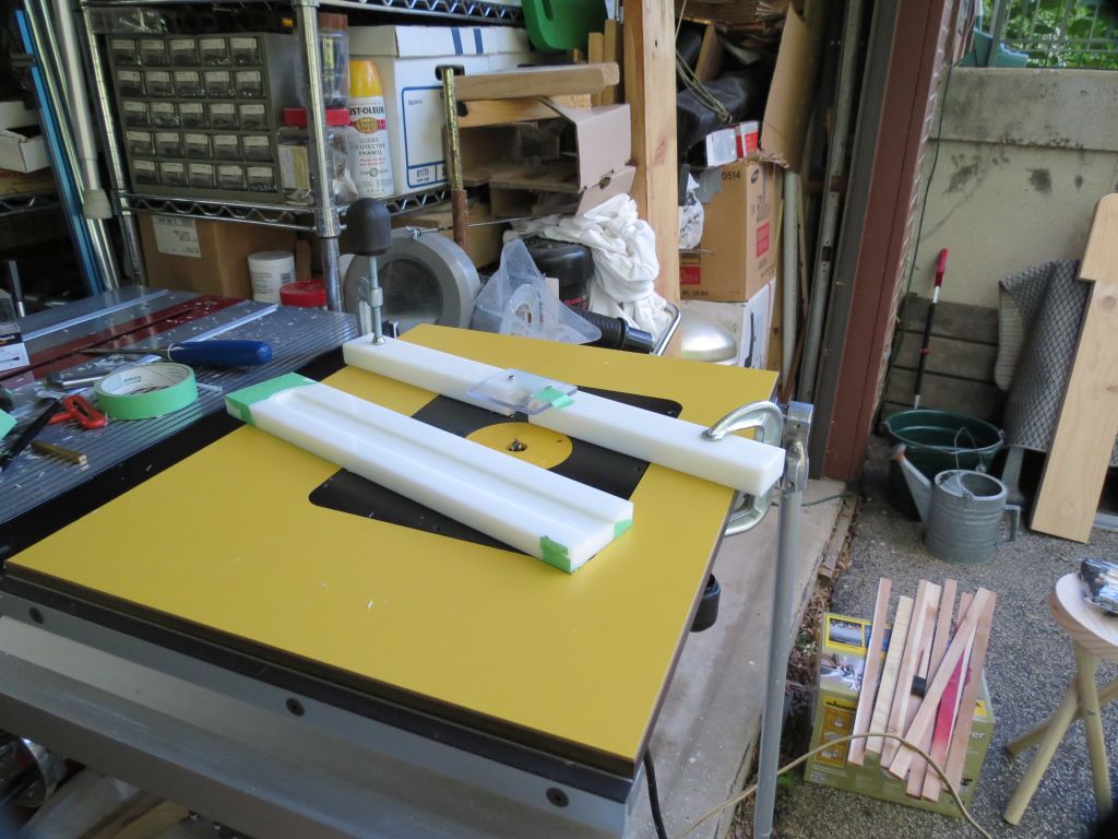

Now I don't have that router table but the one I do have I find I like to use off the end like the link that was published showed. I also like to have space between the router table and the main table so I can clamp a fence in place. This is an example of this method:
Even to do that I use the 5' long tubes. The standard ones are what 28" long, don't see how that would ever work, I mean it works for the main table and extension table and that is about it.
