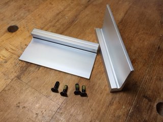

I just completed upgrade from Mark V 500 to 510 and I have the following parts left over. Any idea what they are for? (The small screws have and hex head) Thanks

I do not know about the screws, but the aluminum extrusions are gauges for setting the rails to the table top(s)

Re: 500 to 510 upgrade...left over parts?
I agree on the gauges for setting up a 520, no idea how one would use them on a 510.
The screws are for a sanding disk hub. The upgrade gives you the new longer hug and the 4 screws needed to do the change out.
