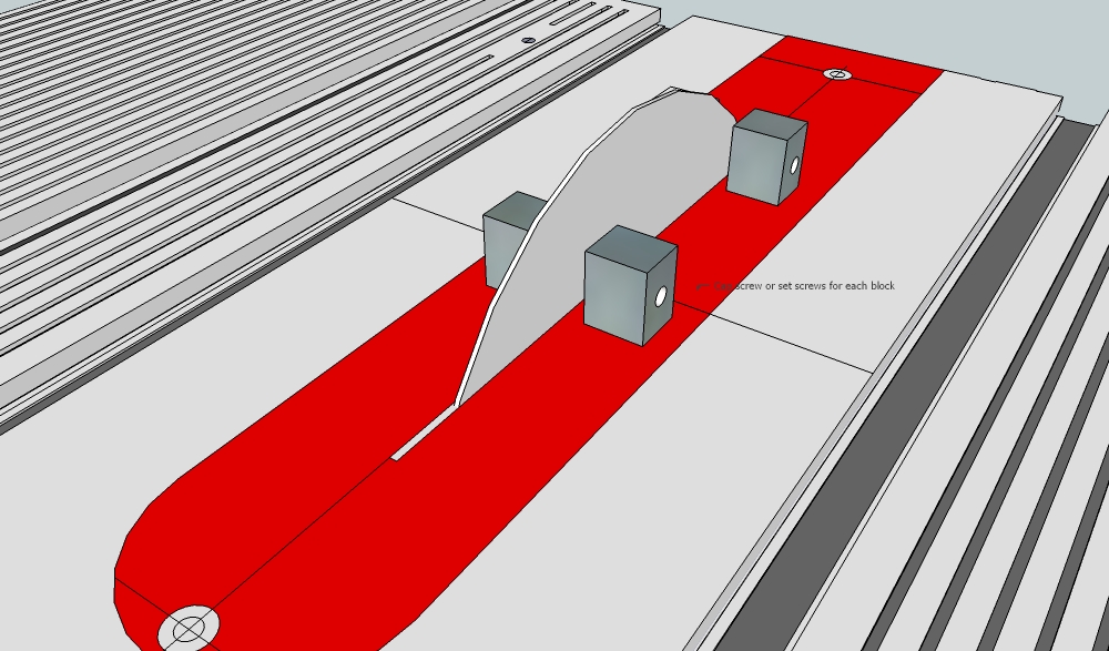

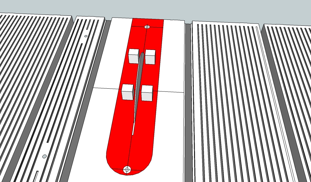

Dusty, you had mentioned a zero clearance adapter made when all was aligned perfectly.
However, what if a jig is made modifying a standard throat plate used when a sanding disc was installed (without sandpaper. The plate has blocks attached with horizontal holes drilled and tapped to accept cap screws or set screws (sorry, in a hurry I didn't show the screws, but I think you get the idea).
Once the table is aligned, this plate replaces the one in the table. The set screws screwed in until they touch the sanding plate, those places are marked on "THAT" plate for future reference and you have a repeatable reference.
In the future when you want to check the alignment, install the dish and orient it correctly, raise the table, install the throat plate and begin lowering it. If it catches, loosen the bolts under the table, drop the table and align with the jig, tighten the table bolts, raise the table and voila you are ready to go.
You do give up a sanding disk and throat plate for single use (alignment) but I think it might be reasonably reliable.
Just a thought. Ideas? changes?

Next thought...
Be well,
Ben
- tbl align jig.jpg (421.57 KiB) Viewed 6804 times
Re: Has anyone made the PALS CTS alignment fit the SS?
benush26:
The blocks (permanently attached to the table insert) with adjusting screws as you describe would certainly work to tweak the table's position (align the table) SO LONG AS the plate that is shown in lieu of a saw blade is stiff enough. The sanding disk might meet that requirement.
I have made a couple table inserts (ZCI) that are 3/4" thick. These were cut at a time when I thought the table was aligned as accurately as I am ever going to align it. When I use it, I loosen all four trunnion bolts, remove the table insert completely, set the table for maximum depth of cut, lock the table in the horizontal position (90° to the blade) and then drop the 3/4" insert down on the blade til it rests on the table. If the table is properly positioned, the insert will fit snugly into the table cut out. If not, the table needs to be moved until it does. Tight the two trunnion bolts that you have access to and the 'alignment is done'. Don't forget to tighten the other two trunnion bolts.
