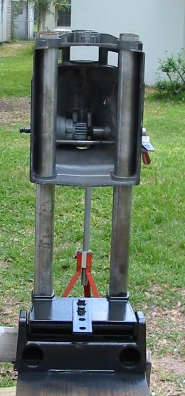

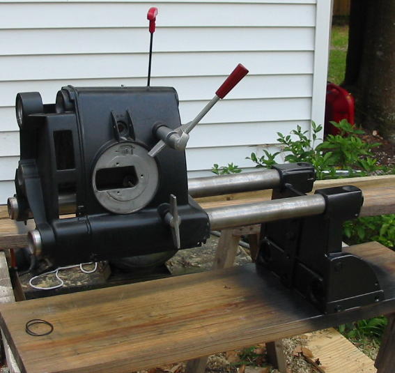

[ATTACH]1321[/ATTACH]
[ATTACH]1322[/ATTACH]I enjoy watch Nick manhandle the Shopsmith headstock in a lot of his videos. I built a working stand for the headstock and can repair/rebuild all SPTs and test them on this stand. I have build it to attach to the tailgate on my truck so I could repair customers equipment at their home but after a couple where I always was missing a needed part, I now only use the stand in my shop. It locks in the up and down position. I normally have some Shopsmith item on the stand for future repairs/rebuilds.
