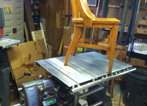

Re: Shortening Bar Stools
The Steve Shanesy method using the table saw worked very well for me today. Only took 15 minutes to set up the 510 and do the sawing/leveling.
Just barely fit front to back, but worked! :D

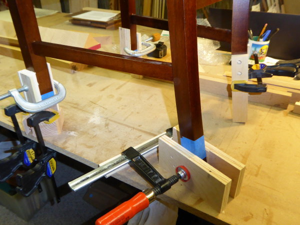

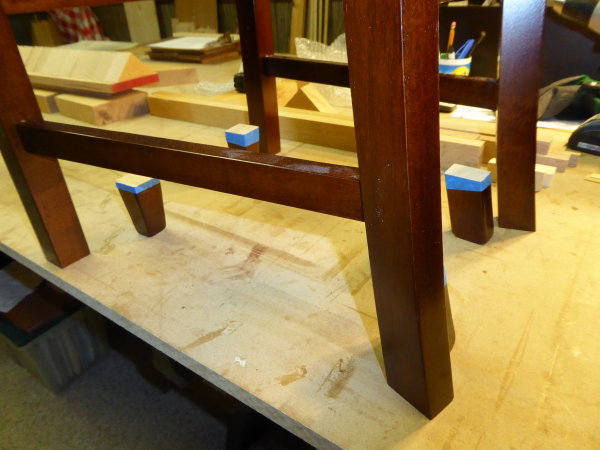

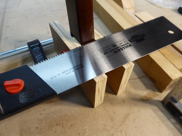

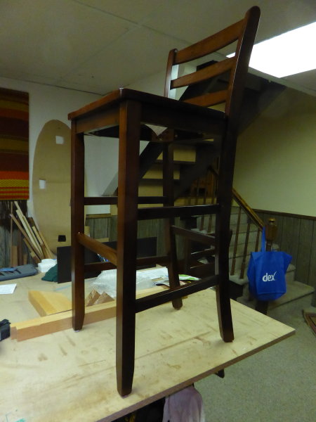

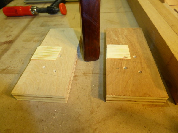

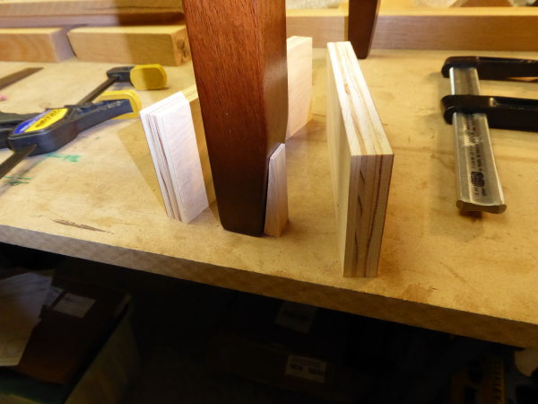

After reviewing the suggestions here and on couple of other sites I decided to use this method. I saw this on a YouTube video.
The stools each have 4 legs and she wanted 3" taken off. I've never attempted a project like this before. So I searched around on the internet and found a link to someone who had a idea that I could copy and I thought it would do the job.
I cut a couple of pieces of scrap pw to 3" by 7" making sure the edges were square. I put them against the legs to be trimmed and by trial and error cut shims so the sides of my jig would be square to the stool legs. When I was happy with the fit I attached them with DST. Then I clamped the jig to a chair leg and used the top surface of the pw as a guild and trimmed the 3" off by hand with a pull saw. Then I clamped a piece of scrap to the cut leg and moved the jig to leg number 2. The front and back legs were different so I needed different shims. Before cutting I used painters tape to cut down and splintering when the saw exited the cut.
This process worked really well. Thanks for looking.

Looks GOOD, But does it rock? :D
Nifty system, Berry! Congratulations on a job well done! The first time doing anything in the shop is always a challenge. You met that challenge in spades!
