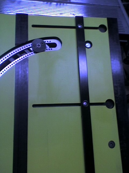

Right out of the box. You should ask for a SS miter bar, no extra cost. As I explained in the review, I forgot to ask, so I just trimmed a little bit (@1/64)off the one that came and it works fine.
The sled is made to work on ANY TS. The secret is that the Miter bar slips from side to side, increasing or decreasing the distance to the blade. Makes the setup more complicated, but once set, you are good to go. Only problem is that with the moving table, if you are not snug to the headstock the sled will rest on the blade. This is because the setup is so close to the blade. This makes for a zero clearance with no sacrificial wood behind the piece you are cutting. I'll try to show a picture of that when I post them tonight.

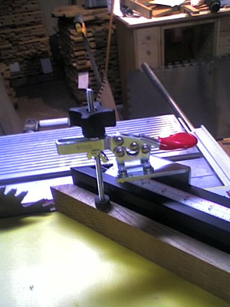

I bought a hold down clamp $25. Since you can cut pieces as small as 1", I figured that might save my fingers.

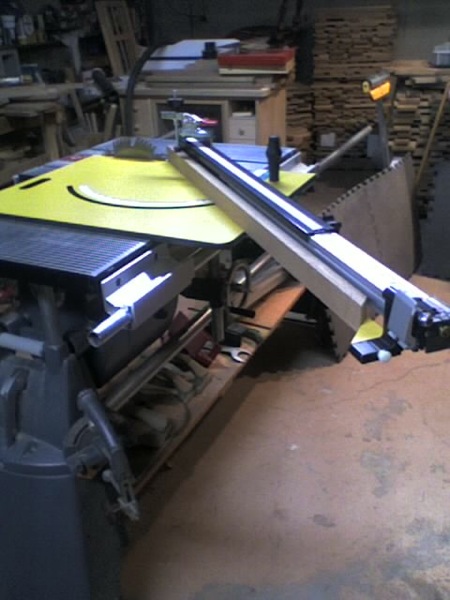

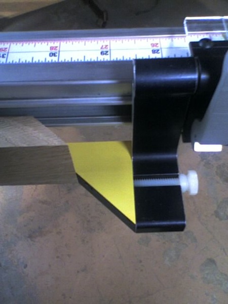

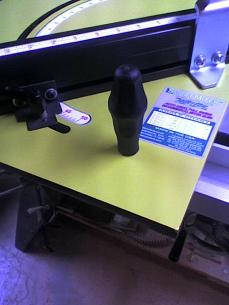

Okay, Pictures as promised
Hopefully, the titles are self explanatory.
Hawk
Hawk
- Sled.jpg (72.49 KiB) Viewed 17972 times
- Handle.jpg (72.14 KiB) Viewed 17957 times
- Angle Block.jpg (59.22 KiB) Viewed 17955 times
- Clamp.jpg (77.37 KiB) Viewed 17946 times
- Sliding Miter Bar Slots.jpg (57.41 KiB) Viewed 17957 times
