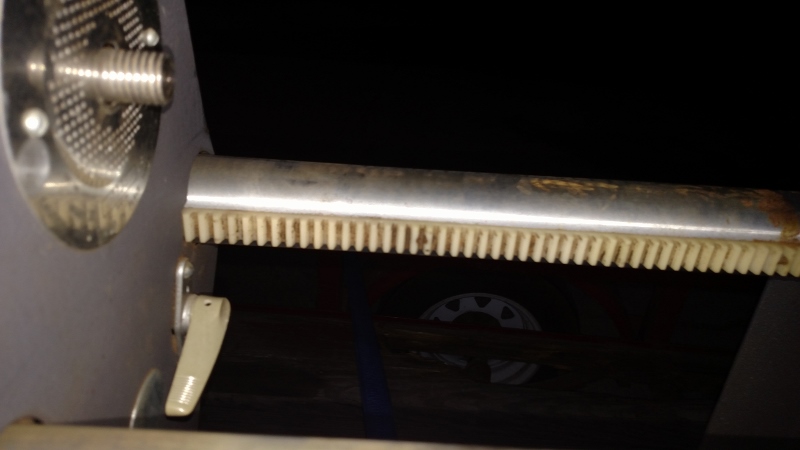

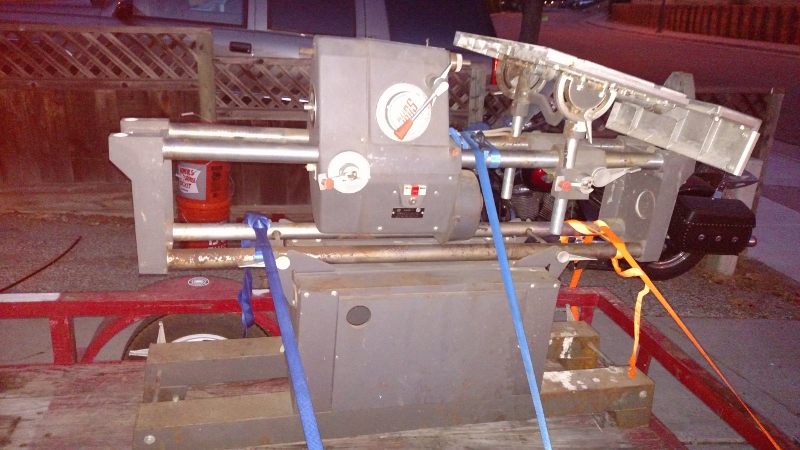

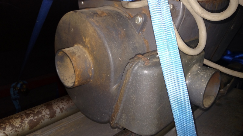

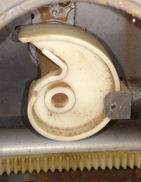

So after reading up on the topic here I took a chance and brought home a $100 Mark VII. The main machine is mostly all there. All of the knobs and levers are intact. Seems to be missing about 6 inches of the gear track but I will give the Delta replacement part. When I pulled the access panel off I was thrilled to see a perfect cam. From the pictures in the ad I thought the DCS was missing but it was actually there and when I turned the unit on was blowing strong. Only really bad part is it seems to have an issue with reverse (only hums).

Yes it is confusing since they are labeled both Mark VII and Mark 7, however they are Mark VIIs.
Re: reverse, the switch is the likely culprit. It has sliding contacts that do not make contact.
Re: rack, it does not go all the way across the front way tube. It should allow 'cranking' to the extreme range of the headstock.
