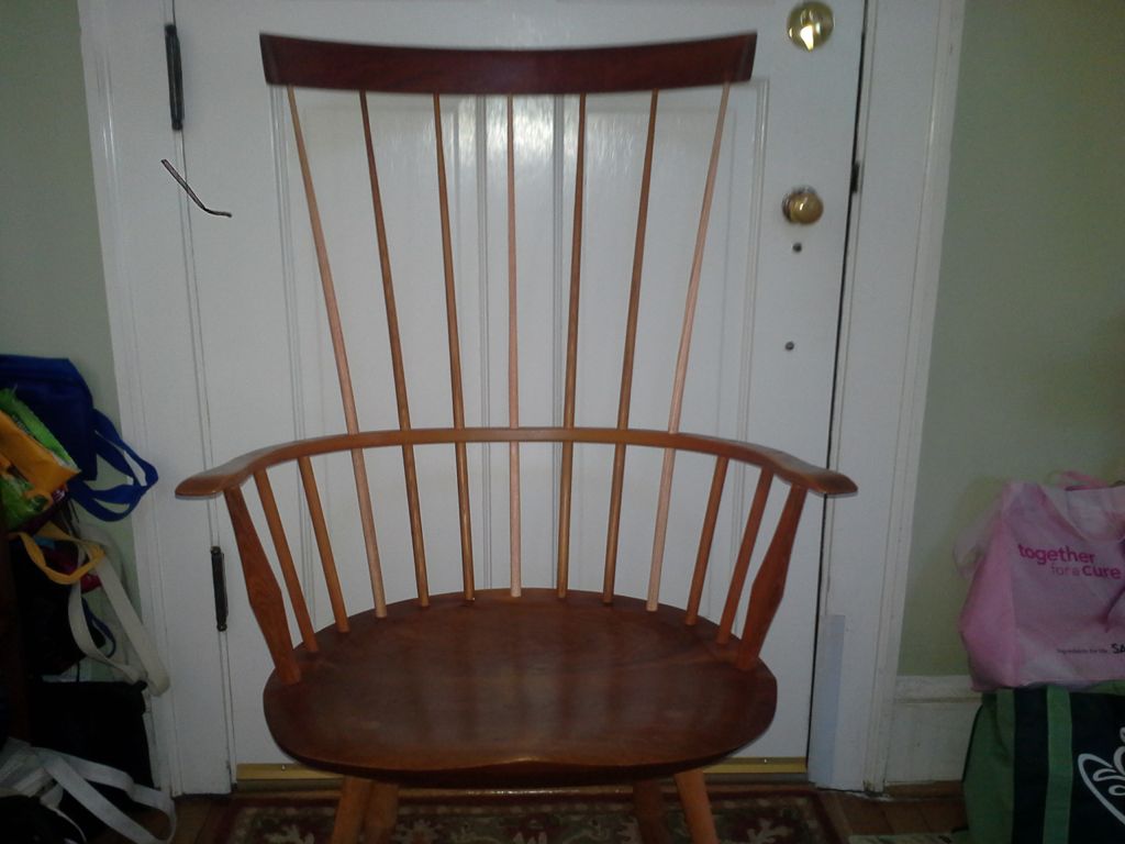

About 20 years ago, my wife and I bought these comb-back chairs from a Rhode Island chair factory. They were a semi-custom variation on one of their standard models. Unfortunately, they've suffered from broken spindles from the get go.
left, right, and middle spindles.jpg (78.59 KiB) Viewed 21668 times

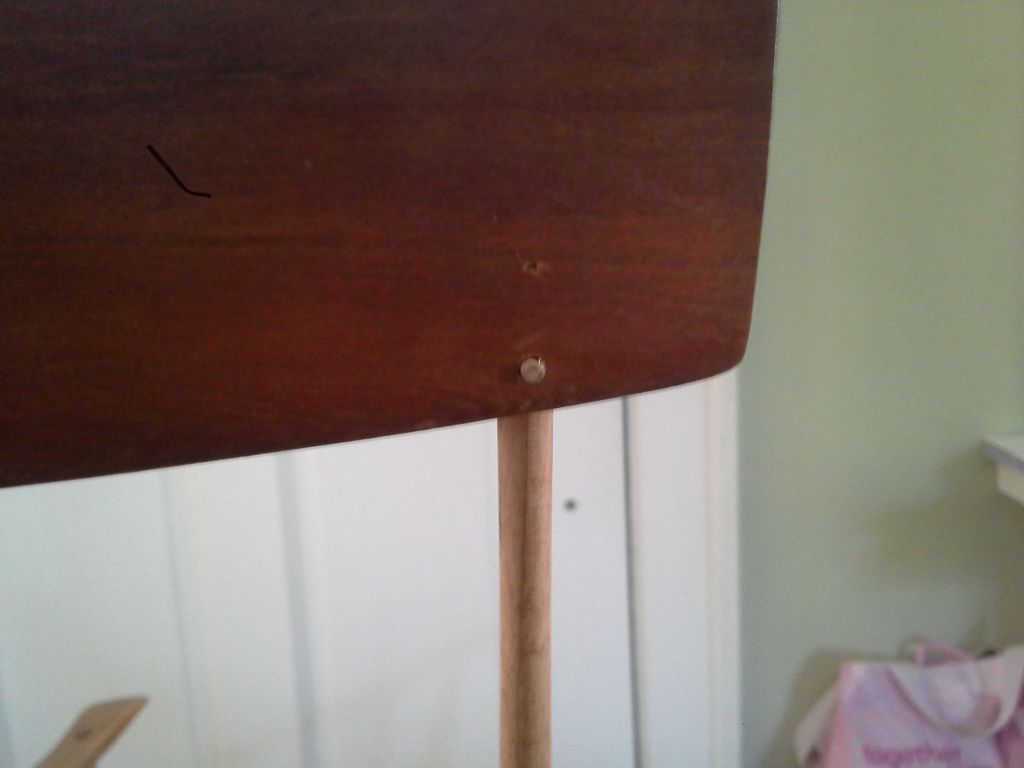

You can see the left, right and middle spindles are lighter than the others. These are the ones I replaced. The originals broke where they were pinned into the top comb.
pinned joint (before trimming().jpg (53.05 KiB) Viewed 21668 times
None of the other spindles broke because they're not pinned into the comb. They're loose in their holes.

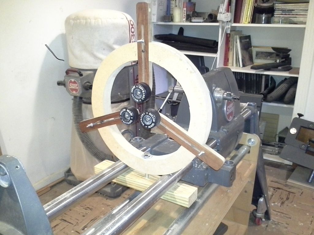

I had 6 spindles to replace for my four chairs. Making the spindles was the challenge. I bought the straightest-grained ash I could find and roughed out octagonal blanks with the Shopsmith's table saw function. I chucked them into the Oneway lathe chuck, but, as many of you would predict, the spindle quickly got too whippy to turn without chattering. I made a quick attempt at a steady rest. The less said about that the better. :rolleyes:
Then I found this one online. http://www.novawoodturnersguild.com/docs/steadyrest.pdf. I mostly kept to the instructions, except instead of using rollerblade wheels, I used roller skate wheels, because that's what I already had in the back of the closet. The rollerblade wheels would've been better.
lathe steady.jpg (118.8 KiB) Viewed 21668 times
The steady rest worked as well enough to get the entire spindle down the largest finished diameter. But, I still got chatter while thinning out the upper half of the spindle. At that point, I finished up with a spokeshave using the Shopsmith as my shaving horse, turning the spindle by handle as needed. The lathe rest served as a backer to keep the spindle from bending away from the spokeshave.
Perhaps there were other solutions. I'm finished now, but I'm interested in what else I could've done.

davebodner wrote: Then I found this one online. http://www.novawoodturnersguild.com/docs/steadyrest.pdf. I mostly kept to the instructions, except instead of using rollerblade wheels, I used roller skate wheels, because that's what I already had in the back of the closet. The rollerblade wheels would've been better.
The link above no longer works, I guess they re organized their web page, but you can download the plans from this updated link. :)
http://www.novawoodturnersguild.com/hin ... dyrest.pdf
