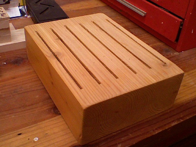

Post by rdewinter »

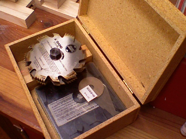

I have a way to easy 10" blade storage that can accommodate two blades with arbor attached. Look at the pics below. Very simple and inexpensive to build. I used a 2x4 as the stock. I cut 5 (or as many as you want) identical 10" pieces and face glued them together. When dry ran the glue up thru my delta portable planer and finish sanded the piece smooth. With the piece on top of my ss saw table, I simply raised the blade into the piece to create saw kerfs deep enough to hold the blades.
For my dado blade storage, I built a box with a scrap piece glued inside the box. Drilled a hole large enough to hold the dado blade with arbor attached. See pic below.
Simple, inexpensive and works well.

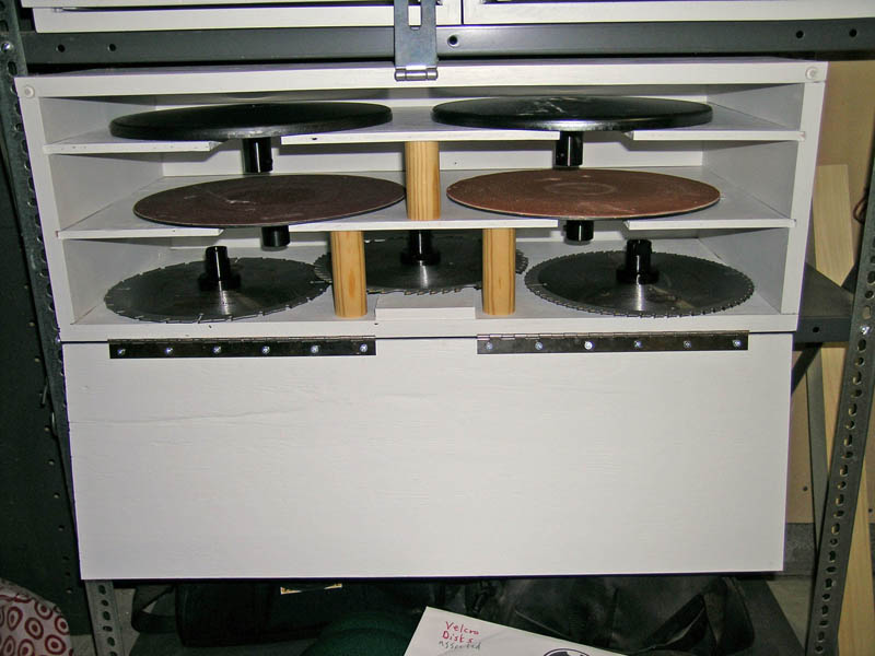

Post by greitz »
This is my horizontal storage solution: three blades with arbors on the bottom, two flat disks in the middle, and two conical disks on top. Plus room to store extra sanding disks, etc. Hint, if you use something better than wimpy 3/8 ply for the shelves, you wouldn't need the spacers to keep the shelves from sagging.
