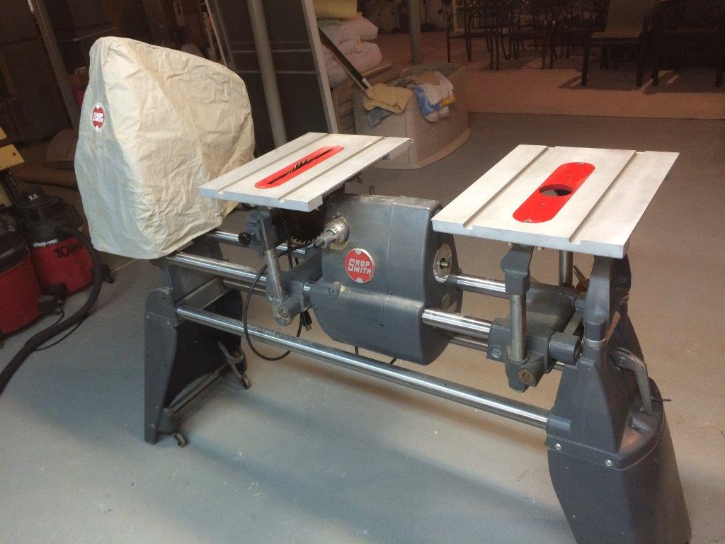

I use a two table setup on one of my units to give me a larger table / support for sawing. It came as a result of having 3 units and converting one to a shortie for SPT use.
Shortcomings:
1) I can't use a standard coupler to drive SPT's because the carriage on the auxiliary side of the unit wont let the head get close enough. Solution: I have a shortie for SPT's!
2) This reduces the length limit for lathe. Solution: If needed I could: a) use my Greenie or, b) use a steadyrest. So far, this hasn't been a problem.
See the picture. Ignore the jigsaw under the cover. I had just placed it there to take pictures of it.
Shortcomings:
- Two Table Setup
- IMG_3827 - reduced.jpg (93.93 KiB) Viewed 1721 times
