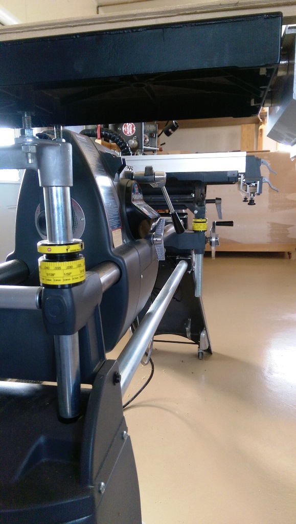

I have the adjustable stop collars on all my Shopsmiths.
http://www.shopsmith.com/ownersite/cata ... collar.htm
Get the height close the normal way and then adjust the stop collar for dead on alignment. The added plus is when using the stop collar the tables are supported on their own during final adjustment. It doesn't take two hands. I also have a 4' straight edge that is thick enough to stand on the edge without holding it. It makes table height adjustments easy. Another advantage of the stop collar is when you change blades or operations. You can raise the table and when you drop it back down it is at the same height.
- IMAG0184.jpg (169.85 KiB) Viewed 3423 times

jsburger wrote:I have the adjustable stop collars on all my Shopsmiths.
Yea, those look handy.

If you are going to "fine tune" the table height (Main Table or Extension Table), they work great. If you are not going to fine tune the height adjustment, those expensive stop collars are "just stop collars".
I have very few occasions where I need to raise or lower my tables .003" or .004". I too own adjustable stop collars. They get used almost exclusively to adjust the depth of a dado.
