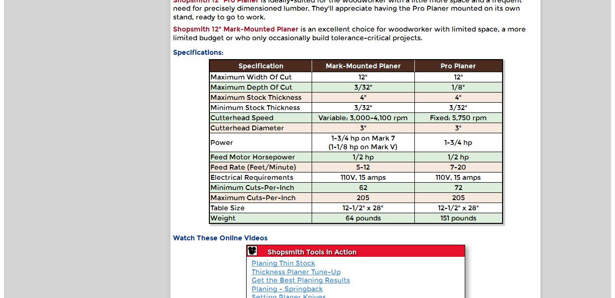

Please elaborate.jsburger wrote:IMO, the conical sanding disk and the knife sharpening jig are worth their weight in gold. They do a wonderful job. It takes longer to remove and install the blades than it does to sharpen them.
I have never used a lunch box planer but have seen them. The SS is much more heavy duty with a solid one piece table. I bought my pro planer years ago before the advent of lunch box planers. I would never consider buying a lunch box planer for any reason.
As for the table. If it is a Pro Planer it will be cast iron. That is one of the things that makes the Pro Planer a Pro Planer. Also the feed rate range is different between the Pro Planer and the MK V mounted planer. The MK V mounted planer has a cast aluminum table. It sounds like what you have is a MK V mounted planer mounted on a power stand. SS does make a power stand fro just that purpose.
Another way to tell is look at the large label on the in feed shield. A MK V mount planer says "Shopsmith 12" Planer". The Pro Planer says "12" Professional Planer".
Either way you have a planer that will last you the rest of your life.
Re: Used Pro Planer questions
From the catalog...JPG wrote:Please elaborate.jsburger wrote:IMO, the conical sanding disk and the knife sharpening jig are worth their weight in gold. They do a wonderful job. It takes longer to remove and install the blades than it does to sharpen them.
- Shopsmith_12_Planers_-_2015-09-05_12.17.52.jpg (100.55 KiB) Viewed 7136 times
