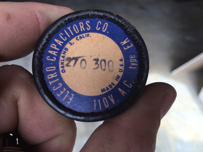

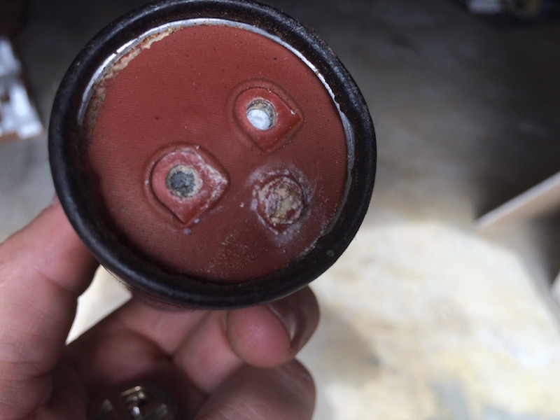

The terminals broke off of the my motor's capacitor and I can't seem to find a replacement. All the ones I can find are 270-324, does this matter? Original was made by Electro Capacitors Co. 110V AC type EK. Stamped 270 300 in the middle. (see pictures)

Picture didn't come through. You probably need to resize it smaller. Anyhow the one you found should be just fine.

Yeah, I was trying to resize, having issues. So the 270-324 capacitor should be fine? Thanks for the feedback. Picture attached.
Markings
Markings
Terminals
Terminals

Yes
