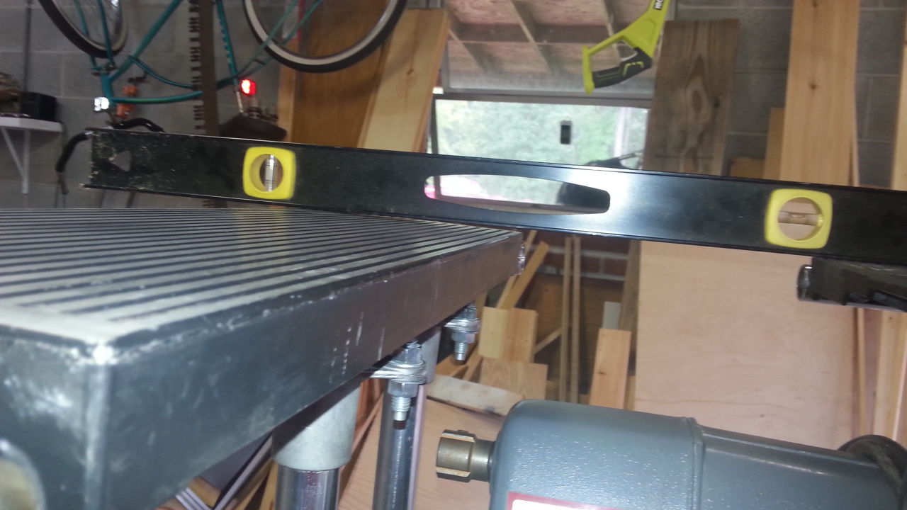

I just finished aligning my extention table on the right side and everything is straight and level. But when I put the extention table on the left side it isnt straight. The is a major gap from the left edge to the headstock. What would cause this? Could it be the leg assembly on the left side?
- 20150906_151045.jpg (297.7 KiB) Viewed 2500 times

It looks like the right side needs to be raised with your adjusting bolts (you can see them in your photo). I am assuming your main table is already adjusted level.

I am not prepared to tell you exactly what causes it. I am prepared to tell you that this is a very common situation. I believe that what you see there is caused by the Way Tubes and Bench Tubes not all being parallel; a slight twist. Many of us use two extension tables. One being aligned on the left end and the other being aligned on the right end and being dedicated to the end on which they were aligned. I used to do that. I have, however, come to the conclusion that the extension tables do not really need to be perfectly aligned.
Test your extension tables to make certain that they are not warped and then learn to live with it. If that is not suitable to you, get another extension table for the other end.
I now have my jointer mounted on the left side and since it has become a challenge to move it, I don't. This leaves room for only one extension table. Problem disappeared (not solved).

If he does that and then moves the extension table back to the other end the alignment issue then will be there. Remember, he reports that he just finished doing the alignment on the right end and then moved the table.Bruce wrote:It looks like the right side needs to be raised with your adjusting bolts (you can see them in your photo). I am assuming your main table is already adjusted level.

If you want to see this whole situation live and in person, stand at one end of your Mark V, grasp the legs and lift them off the ground. Now, let loose with one hand and lower the legs back to the ground. Do nothing else other than check alignment. The tables will not be aligned the same as they were before you lifted the one end off the ground. The tubes twisted. With that twist, the headrest changed position.

Thanks Dusty. I just attempted to fix the way tubes. Hope it helps. But if it doesn't I might just learn to live with it on the right side and the put my jointer on the left. I am contemplating getting the 520 upgrade, I have used the tubes of the 510 a little and so far I'm not too impressed. I'm thinking the 520 fence might be better. I have been reaserching the 520 on here and I do not see anyone saying they wish they hadn't upgraded. This might also be a reason not to get another extention table.

Well just tried on the left again and I wasn't successful. So I just realign on the right and im going to live with it. Thanks guys for the advise.
