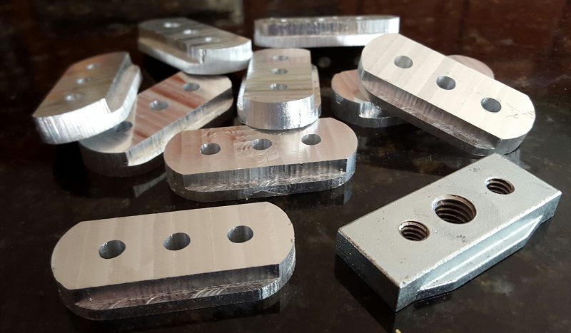

I'm always finding myself wanting more T-nuts, but find the price a bit steep. Today for something different to do I decided to make T-nuts out of aluminum. All cutting drilling was done on my CNC which like most woodworking tools is ok with aluminum if you take it easy.
My version differs in that all three holes are drilled for a 1/4-20 tap because I find myself using that size screw the most. Any of the holes could be drilled bigger.
The other major difference is that I find the Shopsmith T-nuts to be a bit unforgiving when getting them started in the channel. These nuts are rounded to make for easier and quicker alignment. Of course the Shopsmith nuts are ferrous, so they are definitely more rugged than my aluminum version.

Thanks for the kind words fellows! After tapping the first four (see below) I mounted them to my drill vise sled and all is well!
I might make a few more just because, and if I do I'm not going to CNC the holes. The reasons are two-fold:
1) It takes quite a bit of time since I use a 1/8" mill to pocket the holes.
2) I discovered that the PowerPro, set at 250rpm makes a great tapping tool for something as soft as aluminum. So once I have the vise set properly, I can drill, and then have proper alignment to switch over to tapping.
I will probably have the cnc make alignment dimples to help center the twist bit.
I'm also considering making some more-or-less disposable light duty versions out of acrylic sheeting just to see how they work. That is the beauty of a CNC, once you have the design down, you can tweak and play with little work.

I'm not recommending it, but this is what I did:
Put tap in chuck.
Set PowerPro to 250 RPM
Put part in vise, with vise closed enough to keep part from spinning but not from lifting.
(In other words as tap fed, part was free to "climb" tap if my feed rate was off a bit.)
Drop of oil on hole.
Positioned tap on part with gentle pressure.
Pushed go.
Once tap was through (or just short of) pushed stop.
Again, it worked like a charm, and at 250rpm it was very manageable. It took about 6 or 8 revolutions to tap, which at 250rpm is 1.5 - 2 seconds. Most of the time I hit stop before it even went all the way through. Maybe next time the tap won't play as well, but today it worked just fine.
