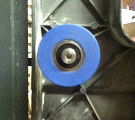

Because the plastic wheels suffer from melt around their bushing even if they are lubricated according to instructions. The steel wheels have bearings rather than bronze bushings. A world of difference!
Getting tired of replacments, I bought these:
New Wheel (2).JPG (64.2 KiB) Viewed 4235 times

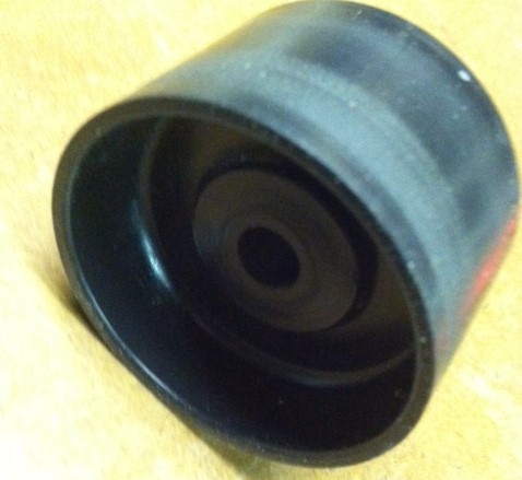

Much better than these:
Old idler wheel 2 (2).JPG (55.18 KiB) Viewed 4235 times
The polyurethane wheels can run continuously for 4 hrs at a time with no issues. Probably can go longer, but I wear out.
The plastic wheels start to melt around the bushing in just a few minutes (maybe 15 or 20) or so and the sanding belt adjustment needs changed. By the time this happens it is too late to save the wheel. I can use it, but belt adjustment suffers. It will never get better.
If wa2crk can get his steel bearings installed for less than $102 He is ahead of me. Best wishes Wa2crk.
