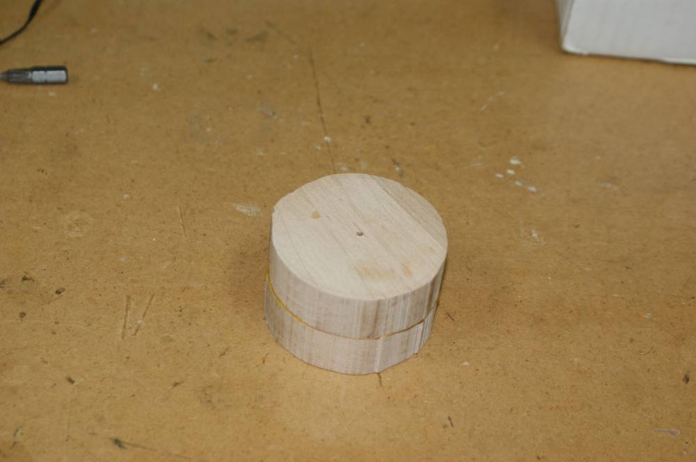

First is to get two pieces of a hard wood such as maple and scribe some circles that are a bit larger than the original idler wheels. Be sure to put a mark on the pieces to mark the center of the circles.
wheel blank.jpg (98.86 KiB) Viewed 749 times
Then take two of the blanks and glue them together with the center marks facing out and allow the glue to dry overnight.

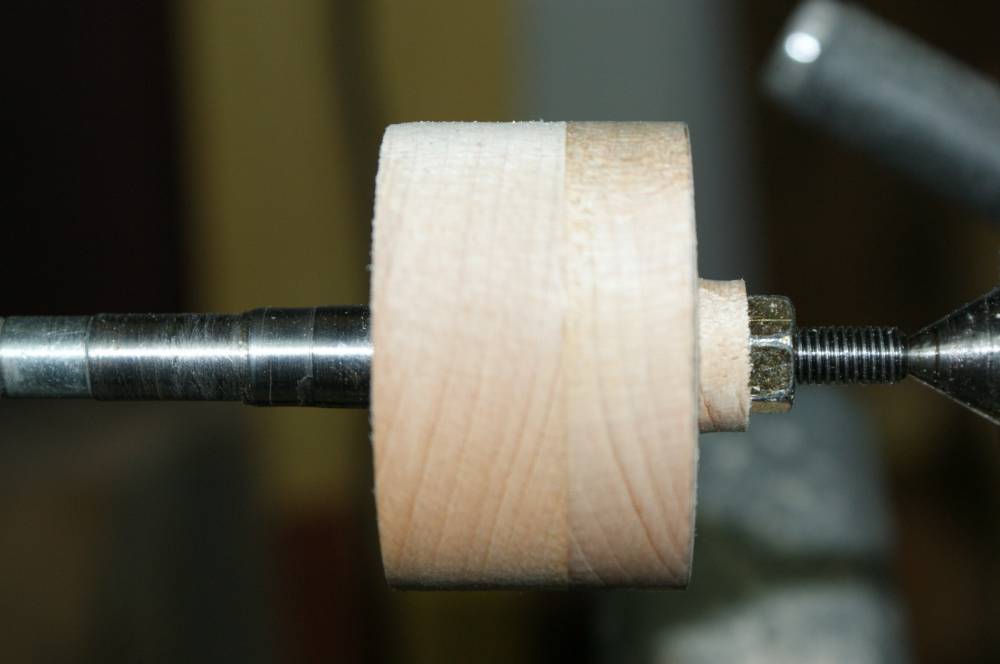

The next step is to drill a 1/4”hole through the blank using the small dimple from the Forstner bit as a center. Then the blank can be mounted on a 7mm pen turning mandrel to be turned or if you do not have a pen mandrel a piece of 1/4” bolt will do.
truing up the wheel.jpg (86.65 KiB) Viewed 749 times
After truing the wheel on the lathe return to the drill press and open the 1/4” hole up to 3/8”.

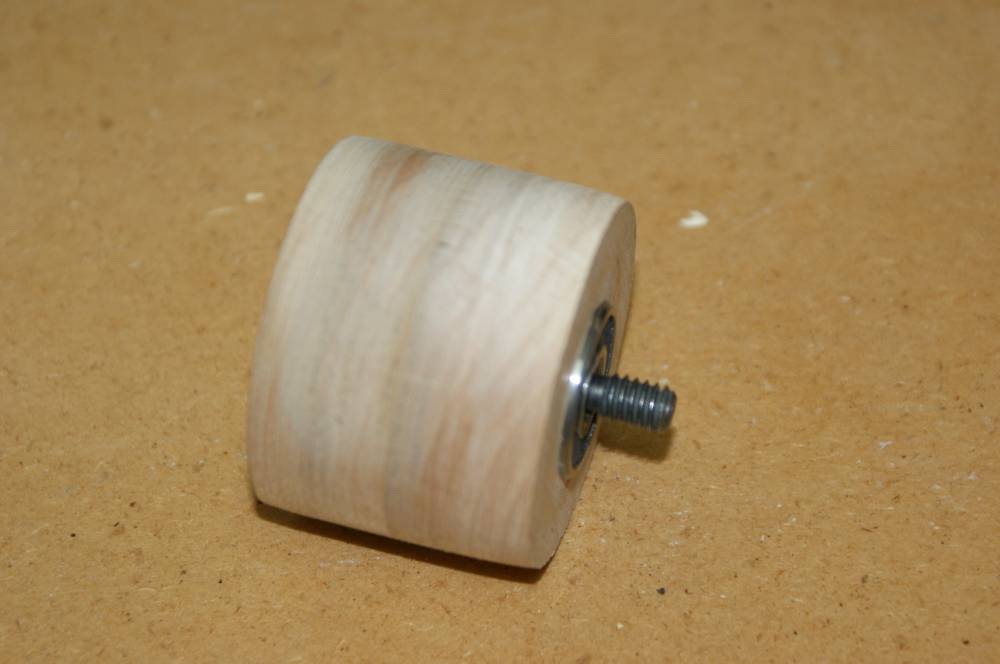

After checking the depth the bolt will fall short and not come through the rear bearing. Remove the bearings and re-drill the deeper hole until you can get a fit like this.
final assembly.jpg (95.26 KiB) Viewed 749 times
