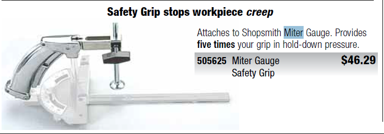

Bill V
Re: Quick clamp on miter guge
Is this what you have?
Capture Safety Grip.PNG (100.1 KiB) Viewed 1090 times
